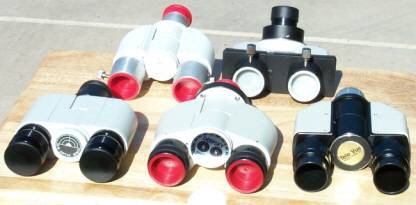

The Contenders
From Left To Right and Front to Back
Brand Price (new) Weight (lbs) Clear aperture Inter-pupillary Adjustment Style
BW-Optik Binocular Viewer (APM-US) $470 1.35 22mm 57-75.5mm Straight through
Deep Sky Binoviewer (Denkmeier Optical) $599 1.85 26mm 49-76mm Straight through
Bino Vue (Tele Vue Optics) $1,030 1.45 26mm 54-78mm Straight through
AY-12 1.5X (LOMO) $375 1.35 17mm 55-74mm Straight through
Stereo Binocular Viewer – Celestron (Baader) $550 1.75 17mm 56-76mm 60 degree

LOMO - dim, brightness variance between eyes, homemade look to the equipment. A few of the reviewers weren't even interested in looking through them based on prior experience or information they had found on-line.
Celestron - excellent view, vignettes 23mm Axioms and 30mm Ultimas and very slight edge dimming on the 19mm Panoptics. Many people had problems merging the views. Can only use in the 60-degree position (no diagonal). Close to same focus as diagonal and eyepiece (good news for refractors). Due to the angle, it was difficult to look at objects up around zenith. One must sit on the ground and look up or raise the tripod significantly. Not comfortable. But, the views that it could manage were sharp and equally as bright as the other units. The previous weekend I had been out to Vekol with only the Celestron Binoviewer. Most people enjoyed the view, but overall the feelings expressed suggested that binoviewing wasn't that great and they would not spend their money on a binoviewer.
B&W Optik - majority declared it the winner on Jupiter. Better contrast, more detail visible. A little vignetting on the 30mm Ultimas (not bad - just a little dimmer at the edge, not dark, but noticeable). During our time with Jupiter it was very difficult to get good results due to the wind. We also discovered a little later that people were detecting a difference between the telescopes/diagonals. Later in the evening, we did most of our comparisons on a single telescope. By then, Jupiter had set and we could not go back and do any more comparisons to see if this conclusion held up when only a single telescope was used.
The Denkmeier and Tele Vue units were definitely the top of the bunch on deep sky objects. No vignetting on any eyepiece, most comfortable for everyone. People who hadn't been impressed with binoviewing the prior weekend are now seriously considering binoviewers. Lots of oohs, aahs and WOWs! People's biggest concern was they wouldn't get to look at very many objects in a single night. They could spend hours just staring at each object! Looking through these binoviewers was like starting over again in astronomy.
People commented that they liked the fit and finish of the B&W Optik, Celestron and Denkmeier units much better than the LOMO and Tele Vue units.
For merge and comfort, the preference was the B&W Optik, Denkmeier and Tele Vue units. With these units all of the people were successful in merging the views at medium and high power. Not any clear winner from the poll, just that these three were better than the other two.
The overwhelming majority picked the Denkmeier for contrast and brightness on deep sky objects. But, this was where we got lots of back and forth from the same people, "B&W wins, Denkmeier wins, Tele Vue wins". After waiting patiently for good seeing, my personal opinion was that they were very close. All 3 of the units provided superb views.

Report card for each unit
B&W Optik Binocular Viewer
Pluses
  • Superb contrast and detail on solar system and deep sky.
  • Highly comfortable to merge and focus.
  • Best fit and finish of all the units reviewed.
  • Machined Delrin plugs in the eyepiece holders rather than the usual plastic caps.
  • Tied with LOMO as the lightest weight unit.
Minuses
  • 22mm clear aperture results in vignetting of eyepieces over about 26mm.
  • Eyepiece holders have grooves running around the barrels. Very slick finish. Not easy to grip even in dry conditions. Would be difficult to loosen and tighten with gloves.
  • Requires a Barlow lens for use with a refractor or reflector telescope. Limits use to high power viewing in those telescopes. More suitable to viewing solar system objects and double stars than deep sky observing in an SCT.
Celestron Stereo Binocular Viewer
Pluses
  • Superb fit and finish.
  • Absolutely no color difference between eyes, even in daylight.
  • Upside down view matches star maps. Not reversed left to right.
  • Only unit to focus without an aid in a refractor.
  • Angle was perfect for a piggyback refractor on an SCT.
  • Least out of field reflection from a nearby bright star.
  • Razor sharp images.
Minuses
  • 17mm clear aperture results in vignetting of eyepieces over about 22mm. Better suited for solar system and double star observations in an SCT.
  • Eyepiece holders use setscrews. Results in less success for people to get the views merged.
  • Sliding style requires re-focus any time inter-pupillary adjustment is altered.
  • Upside down view takes some adjustment for many viewers.
  • Angle frequently not comfortable on SCTs, and probably not usable on reflectors.
Denkmeier Deep Sky Binoviewer
Pluses
  • 26mm clear apertures result in no vignetting on any 1.25" eyepiece.
  • Best eyepiece holder mechanism. Just slide the eyepieces in and go. No tightening. No slip even when unit is turned upside down. Easiest to adjust for diopter differences.
  • Generated the most positive reactions of any binoviewer tested.
  • Optional 1.2X OCS is a clear advance in using binoviewers for deep sky work with refractors and reflectors. Even useful on SCTs.
Minuses
  • Heaviest unit tested. Could result in balancing issues on some telescopes.
  • A few people commented that the logo was a little loud.
LOMO AY-12 Binoviewer
Pluses
  • Tied with B&W Optik as lightest unit tested.
  • Least expensive unit tested.
Minuses
  • Noticeably dimmer than other units. Converted microscope head that was originally designed for use with lots of light.
  • Color difference between eyes most noticeable of any unit.
  • 17mm clear aperture results in vignetting of eyepieces over about 20mm.
  • Poor fit and finish. Unit looked hand made.
  • Front barrel is too long for manufacturer supplied prism diagonals. Could not add a filter on 1.25" Everbright diagonal due to length.
  • Many people dissuaded from binoviewing concept by this unit.
  • Requires a Barlow lens for use with a refractor or reflector telescope. Limits use to high power viewing. More suitable to solar system objects and double stars than deep sky observing.
    Tele Vue Bino Vue
Pluses
  • Good eyepiece holder mechanism. Ribbing on tighteners runs front to back on the eyepiece holders, making them easy to adjust.
  • Among the lightest units tested.
  • Slightly higher magnification makes users with sharp eyesight perceive it as the brightest unit.
Minuses
  • People expressed a preference for the rounded binoviewers. Many didn't like the squared off effect of the Bino Vue.
  • Requires a 2X magnifier to focus in refractors or reflectors. This restricts use to high power in these types of telescopes.
  • The more extensive use of plastic kept the unit lighter at the expense of perceived fit and finish.
