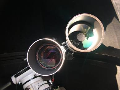

Before using the STF, I made sure I was meticulous with collimation. Incredulous as it seems, the STF arrived from Germany in perfect collimation! This is a good proof of its tremendous build quality. I’ve collimated this scope only once in 6 months and even that wasn’t really necessary. The STF has the standard 3 push pull screws on the secondary should it need adjustment. However it is worth pointing out that the TOA also arrived in perfect collimation. Should it ever need adjusting, which I doubt it would, there are 6 sets of push pull lens adjustment screws showing yet another indication of quality!
Here you can just see the earlier mentioned collimation screws This picture shows both scopes atop my AP 900 GTO mount.

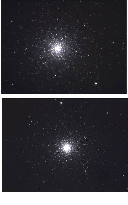

The following images were taken at prime focus with equal processing and similar total duration (10 minutes). The difference in focal length is quite obvious, as is the sharpness. What can be clearly seen is that they are both intended for totally different jobs with reference again to image scale and focal length. Decide for yourself what you think you will image more often and what your requirements are.
Remember that tracking accuracy is very important when imaging at longer focal lengths. If you feel your imaging skills and mount may be pushed to and beyond the limits, the TOA may be the better tool. Because of the British climate, the TOA may also get more use visually and for imaging since longer focal length scopes require more stable weather for imaging.
STF Mirage 180 (top image), Takahashi TOA 130 (bottom image)
