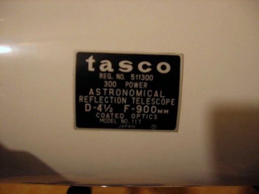

I have not been able to look at the scope in person or see pictures of the scope yet. The Lady that is selling it tells me it is from the 1980's. It is on the EQ mount that came with it when they bought it.
It is a Tasco D4.5 F900. Model 11T Reg#511300

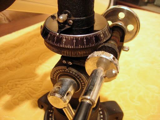

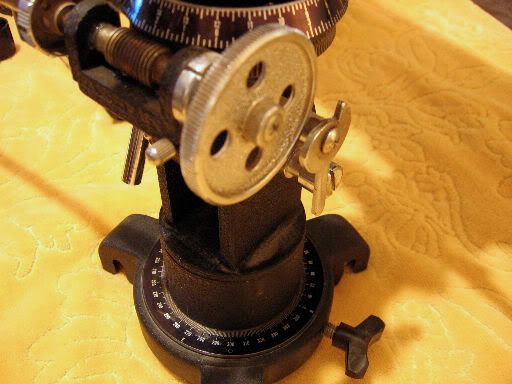

Posted 15 February 2008 - 11:48 PM

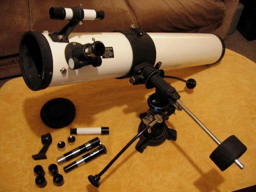

Ok I bought it. I Talked her down to $60.00
The legs are wooden and need some minor hardware. They are
in good condition though for being that old. Not wood rot at all. I can make some little solid pier mount at work to make it real solid.

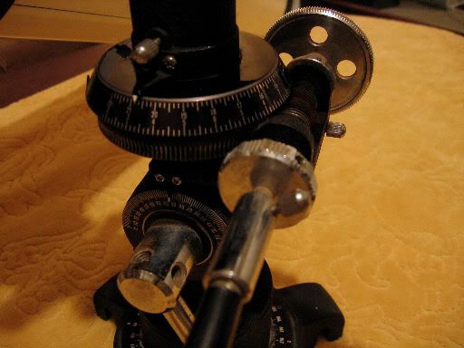

The mount has a tag on the bottom that says "Japan". The mount is very smooth and tight. No chips at all on it. The crinkle paint finish looks brand new actually.
The tube has very minimal scuff marks that I would not even call scratches. No dents or dings.

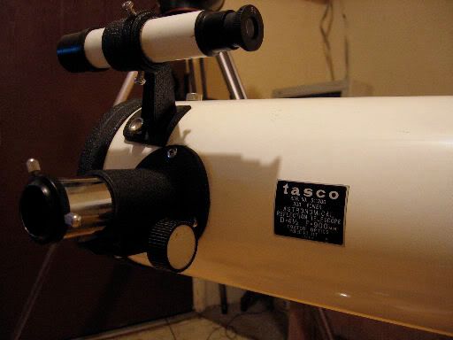

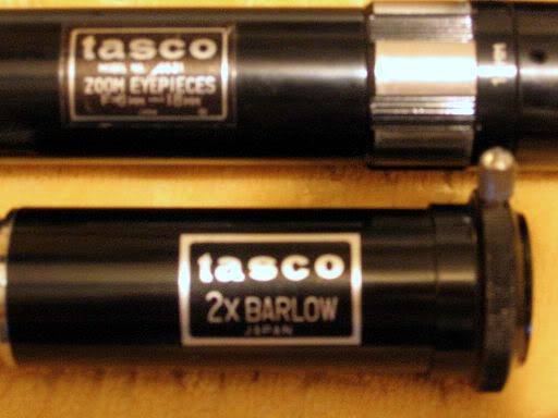

It does have that small eyepiece focuser. :bawling: I will have to put a new one on there. It did come with an extra finder scope and finder scope mount. It also has a 2x Tasco barlow and a Tasco Zoom Eyepiece model #6621. It zooms 6 8 12 15 and 18mm. The zoom EP and the barlow are about 9 inces long when put together. It also came with 2 EPs that has H12.5mm Japan and H6mm Japan printed on the top. They have cases too.

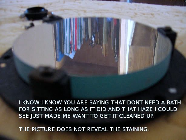

The Mirror looks great. Just a little bit of dust on it. She said It has been stored in some bags most of its life. Overall I am pretty happy. As I said I do not have a mount like this and I really wanted to get one. I think it is a pretty good deal for 60.00 what do you think? Other than dropping money on a new focuser and making a pier mount it seems pretty good.
Here are some pics of the mount and scope...
Well there she is.
Any suggestions on a focuser for 1-1/4 EPs? I have no idea about doing this. I assume I need to buy one for this size diameter tube. Should I just get one from Orion? Thanks for looking and comments.
Rick

Quite a nifty scope you got yourself there, Rick, and a bargain. Those eq mounts are really nicely made, tho sometimes they need cleaning and regreasing.
Congratulations!

Rick: Looks good to me, a clean scope for a good price. :waytogo:
Since you are a machinist, I would first just see if I could make an short adapter that would allow me use the 1.25 inch eyepieces with the 0.965 inch focuser, it's worth a shot and it would keep the scope stock which would be nice. You would get some vignetting with widefield eyepieces but it would probably be not too noticeable. You may have inward focus travel issues but you should be able to figure that out beforehand.

Nice job! White tube looks good, enjoy! Get a 1.25 focuser from a Celestron Firstscope 114. Should fit on the tube without having to drill new holes. I bought one from Ebay and had to cut it down a bit but it works fine.

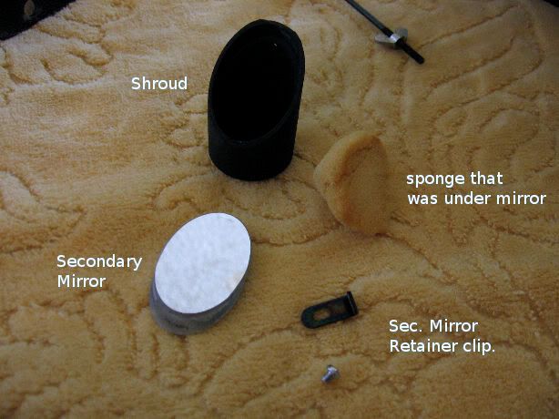

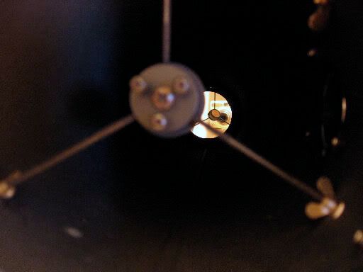

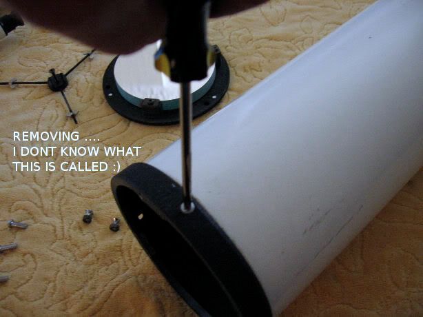

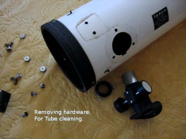

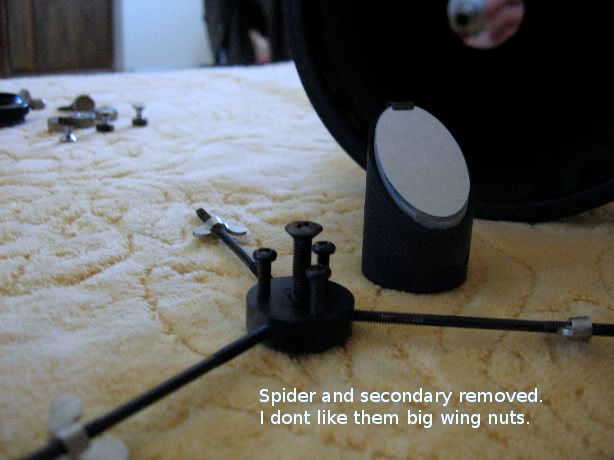

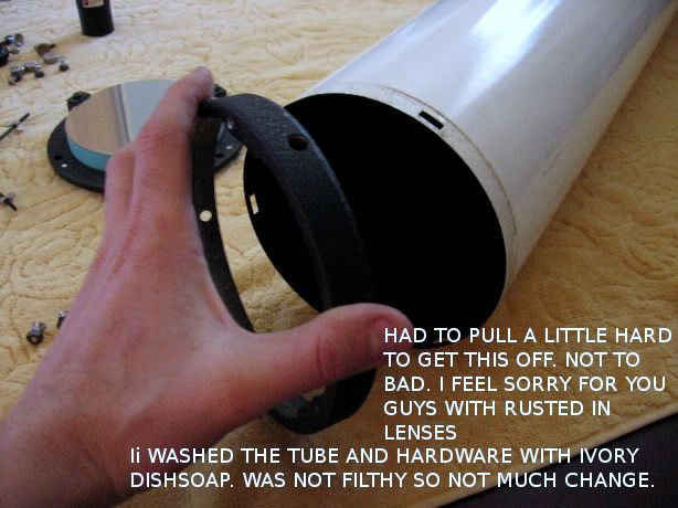

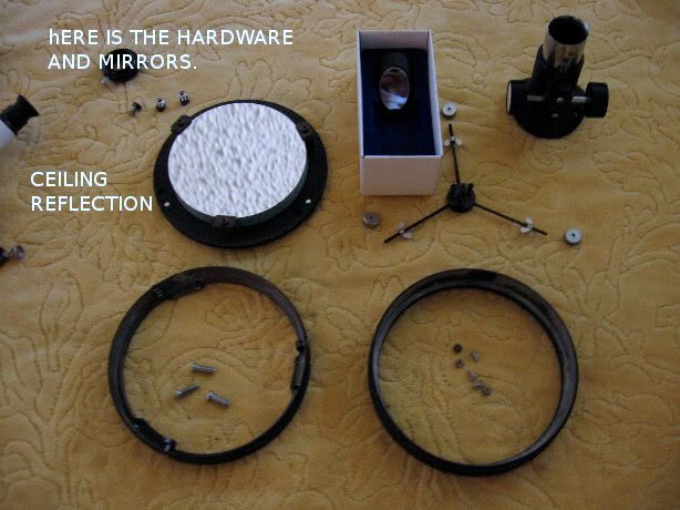

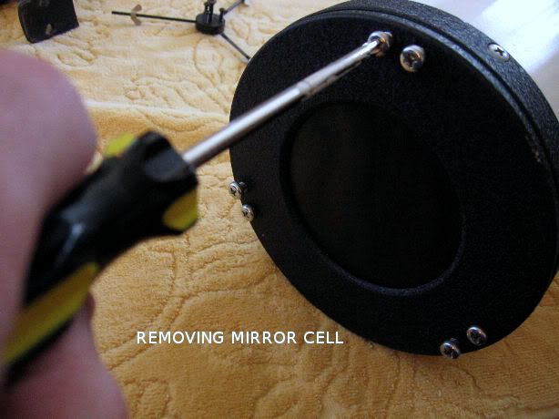

I did disassembled the entire scope to get every little piece of dust out of all the hardware. I wanted to make sure there was no rust situations going on. All was good in that department. When I took out the mirror and had a good look at it I noticed the towards the outer area of the mirror it was nice and clean. Than about 10-15mm in the mirror was real hazy looking. Kind of like a fog. Well I decided to clean it. I used the method at this site. http://www.arksky.org/asoclean.htm Mirror cleaning is on the bottom half of that page. It went very smooth and the mirror looks flawless. I do not have a center mark on it for collimation. I did buy a Orion laser colimator and have the round collimation stickers. Would I want to put one on this mirror? I understand how you trace the mirror and cut and fold the template procedure. Well I have the tube apart still. I was thinking about flocking the tube also since I have it all apart. I have been reading up on that. Seems pretty straight forward.
When I get the 1.25 focuser do I need to get a larger secondary mirror? I noticed my Celestron secondary (D4.5) is about twice the size as the Tasco's secondary.
I will be learning a lot with this little scope project. I am somewhat excited about getting this scope tuned up and working.

I just went through with my 4.5 Japanese scope, what you are about to do with your scope. It was a bit of a process to find the right height and tube dimension for the focuser. I also did not want to drill or modify the OTA.
I eventually got a used Cave focuser sent to me (thanks Larry) but I also had 2 other possibilities if that didn't work out.
If you want to PM me with your email, I can tell you what was needed for a 1.25 focuser to work on that tube, so no adjustments would be needed for the OTA or the mirror.

Here are some pictures of my tear down and mirror cleaning results.
http://i160.photobuc...az/IMG_3296.jpg
http://i160.photobuc...az/IMG_3295.jpg
http://i160.photobuc...az/IMG_3293.jpg
http://i160.photobuc...az/IMG_3297.jpg
Well there is another part to my journey. I have now cleaned a mirror and a tube assembly. Now to find the focuser for 1.25 EPs.
