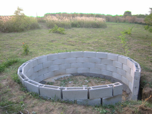

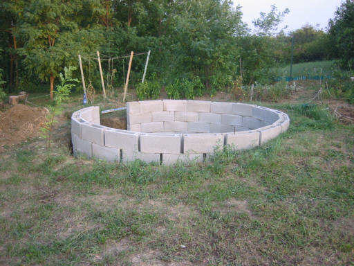

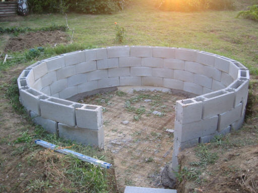

Actually, I'm currently building an underground observatory. At least some part of it is underground (see pics: 1, 2, 3).
As you can see, the 4m diametre dome will be above the ground.
I've thinked over all possible problem sources, and decided to give it a go. The hole has a depth of about 1m with a diametre of 4m. I digged it by hand almost two years ago. I was examining its behaviour since, especially after big rains. But as this place is on top of our "hill" about 22m above the house, there's no sign of ground water even after weeks of continuous rain.
I've read many comments about seeing at ground levels, and realized that if I wanted the scope at a seeing-safe height, I either must use the top of our roof (then I have strong turbulences over the roof any night of the year, so it's not an option), or build such a tall building, that the loooooong pier would shake strongly very probably. The dome design however is good at keeping away wind turbulences from the scope, so it's still much better to have the scope in a dome than to have it standing on a tripod in the yard. I've also noticed that on the top of the hill there's only a minor sign of moisture even if down in the valley we have a fog, which is quite common throughout the year.

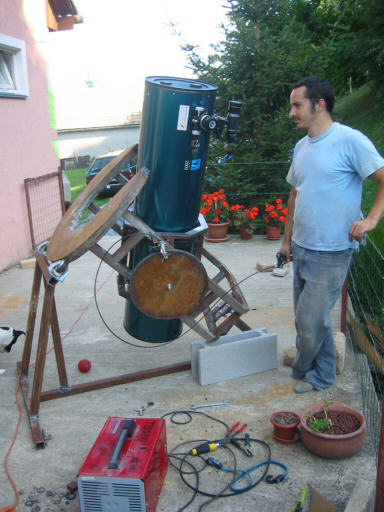

Btw, I'm building a horseshoe mount to be placed in the underground observatory (here's a pic), to give the scope even better stability than a normal pier.
Why underground then, you may ask? The answer is that I _think_ the scope mirror will stay closer to a thermal equilibrium state, because the ground around the mirror will keep a colder temperature inside the dome than what a normal domed observatory could provide. That is essential for me, because we often have days especially during the summer, when the temperature falls so rapidly during the night that the mirror just can't keep up with this rate, and fails to reach the equilibrium through the whole night.
Anyhow, I'll finish the walls this week and start to build the dome, so I'll be able to report the first impressions soon, if you're interested.
