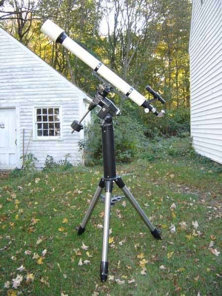

I bought that extension for my SVP after being convinced here that it would make my refractor viewing more comfortable. It took several months to get since they were out of stock at the time, finally showing up a few weeks ago. I used it on the tripod for all of about 10 minutes, before removing it and putting it back in the box.
The thing was heavy, 13-14 lbs, made of quite thick-walled steel. It, with the mount head on top, was way too much mass for the SVP tripod to control, damping times were excessive and any little breeze caused jiggles too. And this was with the tripod legs fully-retracted, as compared to always using the tripod with them fully-extended normally. Besides which it made the assembled tripod and mount head a real pain to carry around.
It was claimed to work ok on the CG5 tripod (2" legs as compared to 1.75"). Maybe so, but if indeed so that would have to be the minimum tolerable tripod size, in my opinion.
If you really want extra height, replacing the tripod legs with longer wooden ones would be the way to go, I now believe. My solution so far is to use my chair more often.

I don't know about the extension as it relates to the Astroview but I did use it with my SVP mount and it was fantastic! No but about it, it made the mount more stable than extending the legs out. I mean this thing was rock solid. I even had an Antares 6 inch f6.5 refractor mounted on it and it was still very solid. As I said I'm nort sure how it translates to an Astroview but for the SVP I highly recommend it.

I have agree with you. I have a SVP mount with the extension and have a Meade AR-5 mounted on it and it is rock solid. I have anti-vibration pads but never use them with this setup. As you said, I don't know how it translates to an Astroview, but as far as the SVP, I wouldn't hesitate to recommend it. IMHO

The Orion pillar will indeed mount on the CG-5.
My 76.2mm F/16 vintage Tasco rides steadily atop it.
