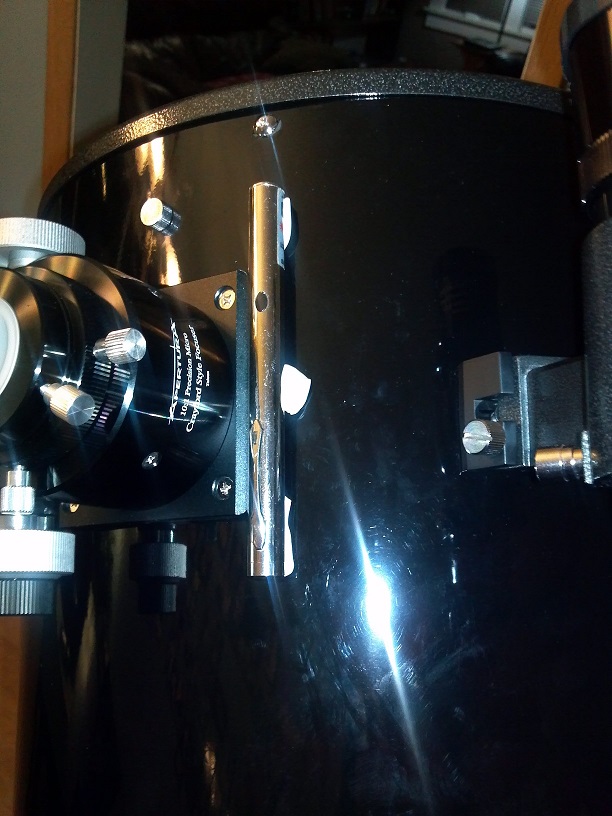

I replaced the focuser tension screw with a hex screw because I kept tightening and loosening the wrong one when viewing.
You could have just removed the bottom thumb screw from your Crayford focuser altogether, (which is a focus lock screw), rather than replace the top thumb screw, (which makes the focusing tight or loose), instead.
I have the bottom one on mine right off.

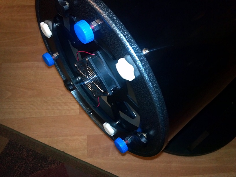

The extra holes in the primary mount on the AD12 are 8x1.25mm. I added bolts and pressed on some bottle caps filled with sticky tack putty for feet to protect the primary adjusters. I also used tack putty to mount my GLP. Butting it up against the focuser mount lines it up well enough to get whatever it's pointing at in the finderscope.
