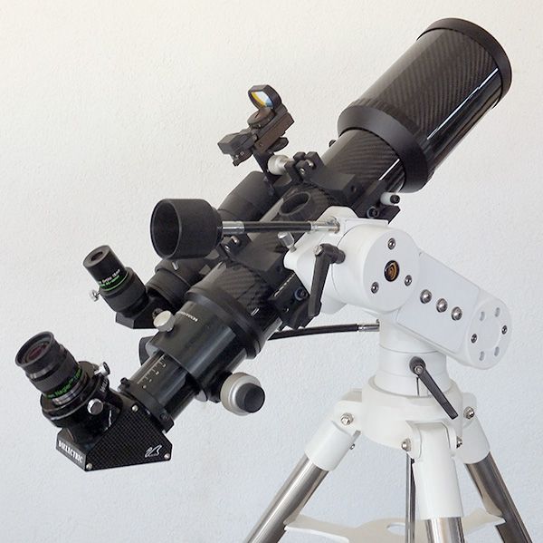

I too experienced some vibration and traced it to the arm. There is a bit of flexure in this component. My solution was to add two steel plates and essentially fill the opening in the arm. Vibration and damping time are significantly reduced. The photo shows this mod. This entire setup (minus the Nagler) weighs 11.2lb. or about 75% the rated capacity of the mount.
Nicely done!
Looks like a great idea.
I had mine out tonight with my C5, It worked really well.
I used some vibration pads and dampening time after a good rap to one of the tripod legs while using 150X was only about 2 seconds.
Acceptable for this class of small mount.
I'm looking forward to trying my 105 F-6 achromat on it.
The tripod could be a touch taller, but so far I'm very happy with it for a lightweight grab and go type mount.

Posted 11 January 2013 - 01:46 PM
Steve,
The mod reduced my damping time to about 1/2 second (certainly under one second) and touching the focuser induced very little movement. I also found that leg vibration in this mount was virtually nil on a hard surface if the rubber leg tips are removed. I think that my AV pads work best with aluminum leg tripods. The steel legs used by ES are very stiff and don't carry much (if any) vibration in my setup.
