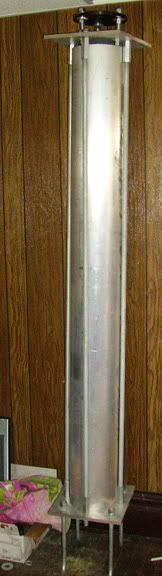

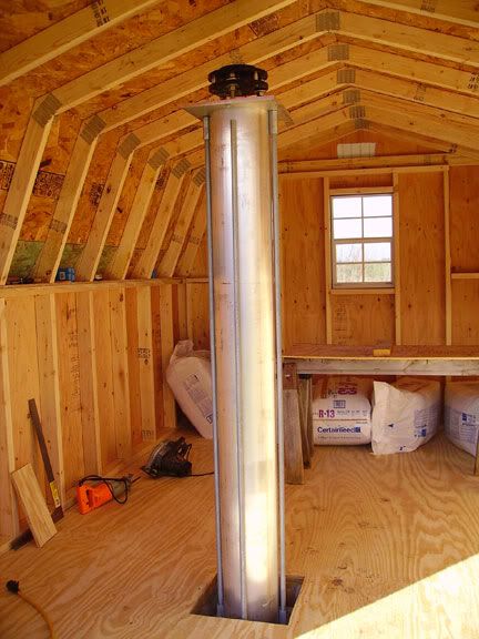

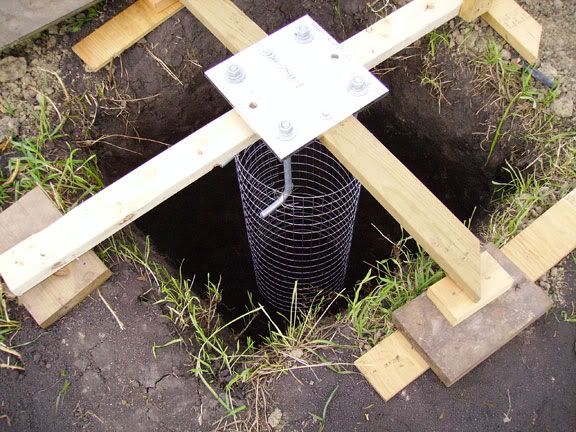

Dug by hand 3x3x4 feet deep
Concrete poured, I am lucky and the truck could back up to my site
Pier is 6 feet of 8 inch 1/4 inch wall aluminum tube in compression
Pier mocked up in the house
Hope this gives you some ideas.
