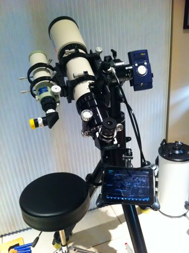

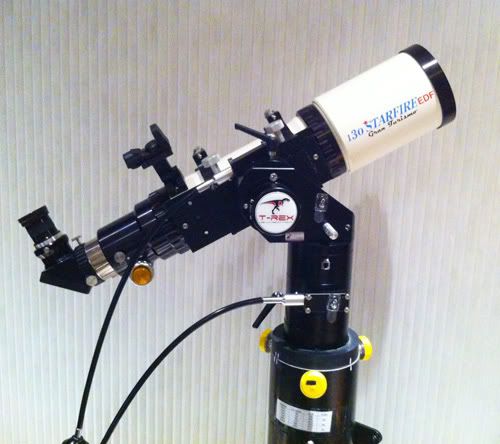

Another vote for the T-REX.
I have one and I love it. I use it with my A-P 130mm EDF GT and also with my C9.25. The slow motion controls are wonderful - smooth and super easy to use. But you can also disengage the slow motion clutches and simply push the scope if you so desire.
I had a Discmount 4 that I used with a 4" refractor (an A-P Traveler). It is a very fine mount but lacks slow motion controls. It also lacks clutches that can be easily tightened or loosened by finger touch. With the T-REX, with the clutches engaged, the object of interest remains in the F.O.V. when switching observers... a very big plus for out reach or just sharing the night sky with friends.
I also had a Quarter Hitch that I used with a 4" refractor and with a 6" Mak. That is also a nice mount, but quite sensitive to external motion. I.e., the slightest touch and it knocked the target out of the viewing field... quite annoying when trying to share views with others. In fact, that is the main reason i sold it. Plus the slow motion controls were difficult to use - poorly positioned and could not be locked down sufficiently.
Yes, the T-REX is expensive, but you get what you pay for. It is rock steady, can be used as a "push" mount the way one uses a DiscMount, a half hitch, a Giro, etc., but is most enjoyable when using the slow motion controls. The T-REX is a high precision mount. IMHO, it is to Alt-Az mounts what the A-P 900 is to GEMs.
The ends of the slow motion control cables are cut off in the above photo.
In this photo, you can see the Argo Navis DSC (Digital Setting Circles), but my SkyFi unit is hidden behind the Argo Navis. The SkyFi wirelessly connects the Argo Navis data to the Sky Safari Pro software app on my iPad. This is one slick combination and makes it extremely easy to find objects and a lot of fun to explore the best objects in the sky during an observation session.
(I usually do not keep the TAK FS-60C mounted, as shown. In it's place I usually mount a Dew Buster control unit. The tripod is a Losmandy G11 with a cut down extension.)

Nice setup Larry.
