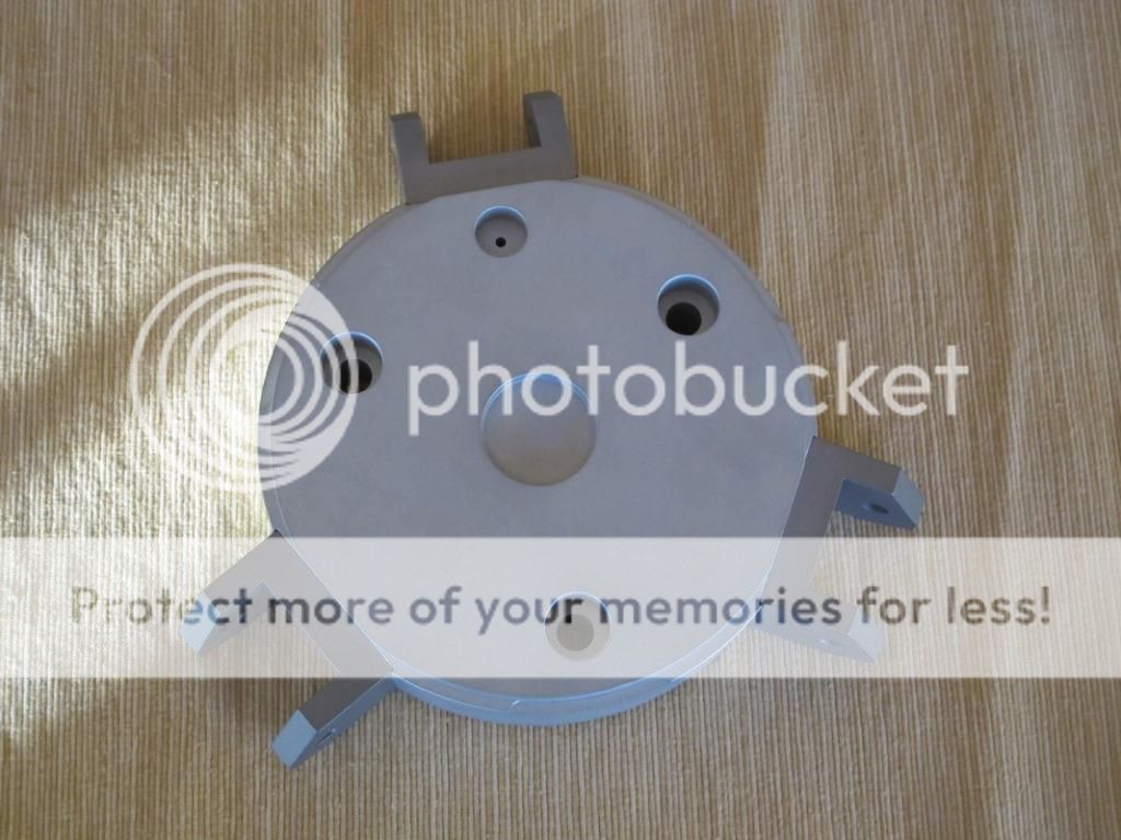

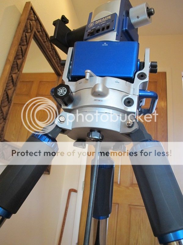

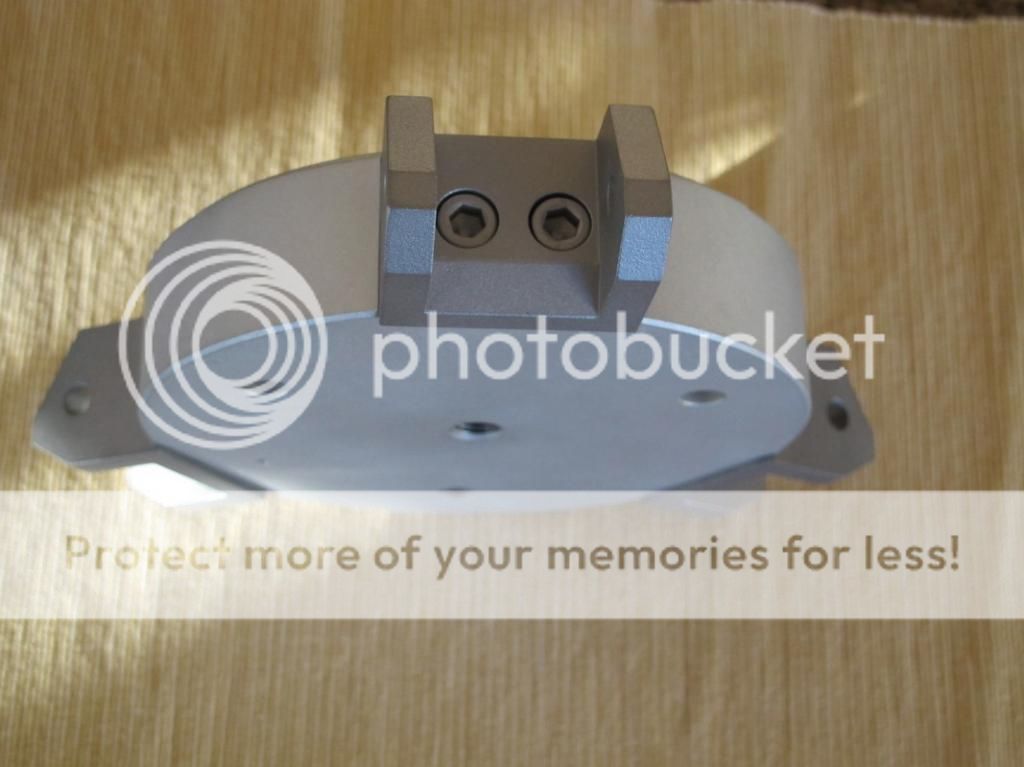

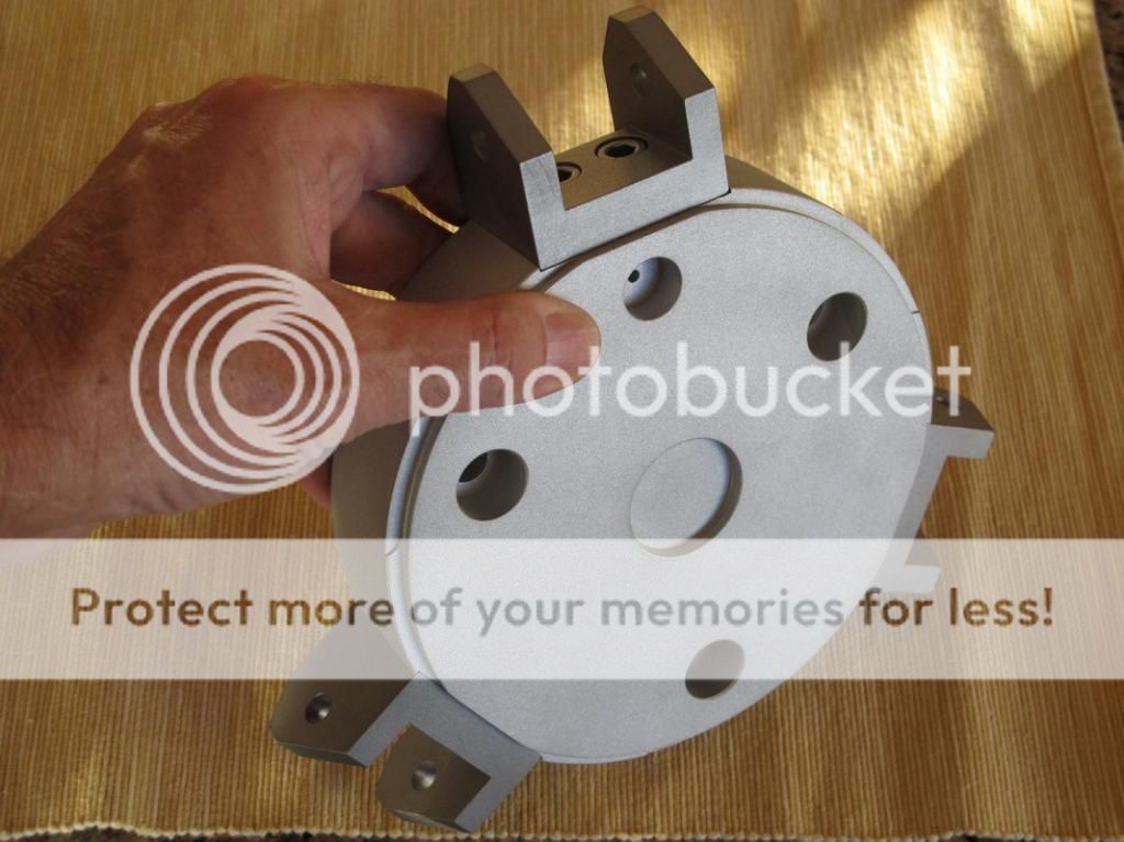

Well, I bought a LX80 by accident because I ordered it last April, kind of forgot about the order and then received it about a month or so ago. I've used it a few times now and actually have enjoyed it.
I've read all the LX80 threads and was concerned about the lightweight tripod top. Also, upon first inspection and use, I sort of thought that this particular LX80 might not have much of the AZ slop being discussed.
Thus, in order to avoid a tripod failure and to try and gain some tripod stability and minimize vibration, I asked a machinist friend to make a beefier top.
Here's our version the LX80 tripod top:
The top is billet aluminum and the leg lugs are steel. The dull finish is from bead blasting.
The new top width is the same width as the attachement bolt posts on the OEM top. The allen bolts are about 2 1/2 inches long.
The little hole by my thumb is for the OEM bubble level; LOL...
The new top basically has the same dimensions as the original top.
Although the center rod attachment lowers the tripod spreader triangle a little, it still fits fine.
Everything assembles perfectly using the homemade top.
Inlcuding counterweights, the above is about 50 pounds or so.
My only use is visual and outreach. Although I've used the LX80 several times in alt/az, I have not set it up in EQ yet. Last night was the first use with the new top.
The new top definitely removes any worries that a leg might break away. But maybe there was only slight gain in overall vibration removal, if any.
To be honest, last night was the first time I really checked the LX80 az slop being discussed in the other thread. I now better understand the issue but am not really worried about it since I am visual only.
Anyway, I wanted to share my solution to the LX80 tripod top weakness. Before I asked my friend about machining a new top, I was going to install small diameter tie bolts on the OEM top for increasd strength and fill the whole underside area with epoxy resin.
So far, I like the LX80 because it is relatively easy to set up and I like Sandy Wood LOL... Next I will try the EQ configuration to see how stable that is.
thanks,
Axle

Thanks for the information. That top is nice looking. Is your friend interested in making any more? If so, let us know the price.

I noticed that when I added the replacement tripod top that my machinist developed, the mount was more steady than with the stock top. But some of that may have come from not having to fear overtightening the spreader and having a leg snap off. If you are going to use the LX80 for purely visual observing, you may find it satisfactory in Alt-Az mode. The damping time for mine when using a C9.25 was about 5 seconds if I tapped the diagonal. I don't know how heavy your refractor is, but it's longer than my SCT, so it may result in slightly higher vibration. My damping time doubled when I set the scope up in EQ mode.

The new top looks very substantial. Nice. What js your damping time in az and equatorial mode? What's the thickness of the material behind the Allen bolt on the U section?

Thanks for your replies.
I do not have an exact damping time yet because the wind was a little breezy. So really, my previous comments regarding vibration are very loose because the wind was enough to affect the dampening. In fact, the wind eventually ended the session.
The material thickness behind the bolt head is about 3/16" - 1/4" or so. i do not have the exact measurement. We were going to make it thicker by cutting a deeper notch into the disc and leave more material on the back side of the U. But that extra material was not necessary to attain the strength needed. The bolts will never pull through in any scenario in this application. Interestingly, this specific aspect was discussed several times to ensure it would be enough. Another option we were considering was to remove some material off the front of the bolt head and having a shallower cup.
Unfortunately, there are too many other projects in the que to make any more of these at the moment.
I will try and get some dampening times the next time out.
