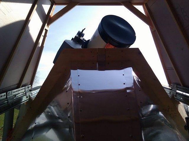

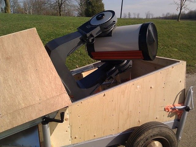

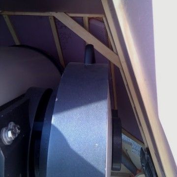

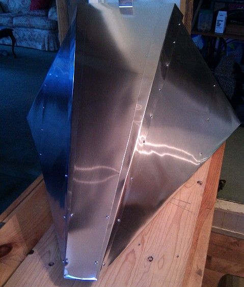

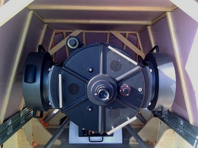

I've had a bit of time to work on the cruiser so I figured I would share a few pics.
The newly skinned and insulated roof attached to the body of the trailer. It may be a bit of a challenge to cover the roof in aluminum as some of the pieces have a bit of a twist. The aluminiumized nose certainly does shine however. It isn't against the law to have a shiny vehicle is it? :)
Posted Image Posted Image
From the inside it can be seen that there is very little wiggle room for the mount. I will need to make sure the scope is in the home position before attempting to open or close the roof. The amount of area above the scope is deceiving also. As the roof travels downward on an angle when opening the back of the roof must be a fair bit higher than the front or else it will smack the scope on the way down.
The idea was to wrap the roof around the front of the trailer to save on space and attempt to minimize the amount of "lift" any gust of wind might have on the setup. It provides a rather unique look at the scope too.
I am still amazed at how large the SCT and forks look in relation to the rest of the trailer. The basic idea was to allow for as much "air" around the scope as possible to minimize destructive currents from interfering with the telescopic seeing. Hence the walls are low allowing for viewing of the eastern and western horizons. The roof rolls off directly to the south and therefore presents a bit of an obstruction in that direction. Yet because the trailer is so "slim" we should still have low views of the south-east and south-west horizons.
