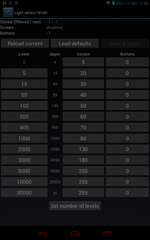

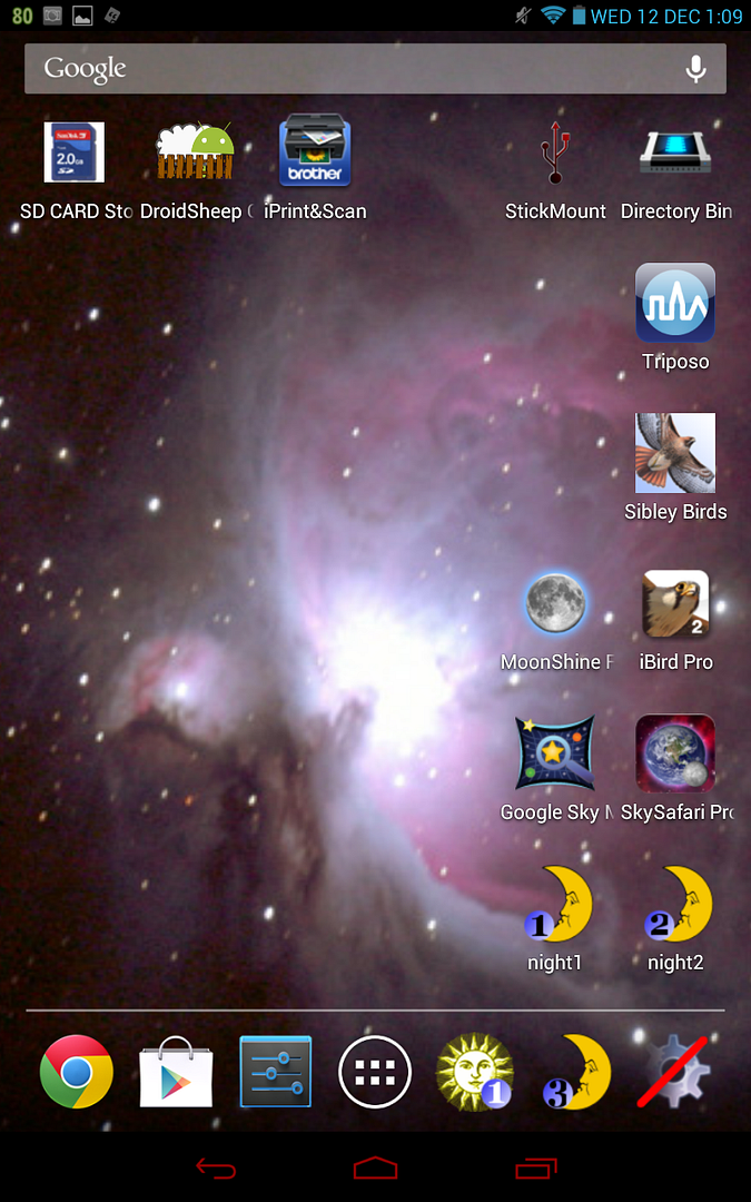

Posted 12 December 2012 - 04:27 AM
I thought I would update this thread with some details on how I dim my screen for night vision use. I use an app named Screen Dim, which allows me to set 2 different day brightness settings and 3 different night settings. Each setting can be a separate combination of brightness (top slider bar) and contrast (bottom slider bar), and is linked to a different icon. See the screen capture below to see the Screen Dim settings selection screen, and its minimum settings. The reason you can see them is because the demo option (see OFF button in upper left) is turned off.
The next screen capture shows my home screen with 3 night brightness & 1 day setting (the moon and sun icons), plus a Screen Dim cancel icon (the gear icon with the diagonal red slash) in the lower right corner.

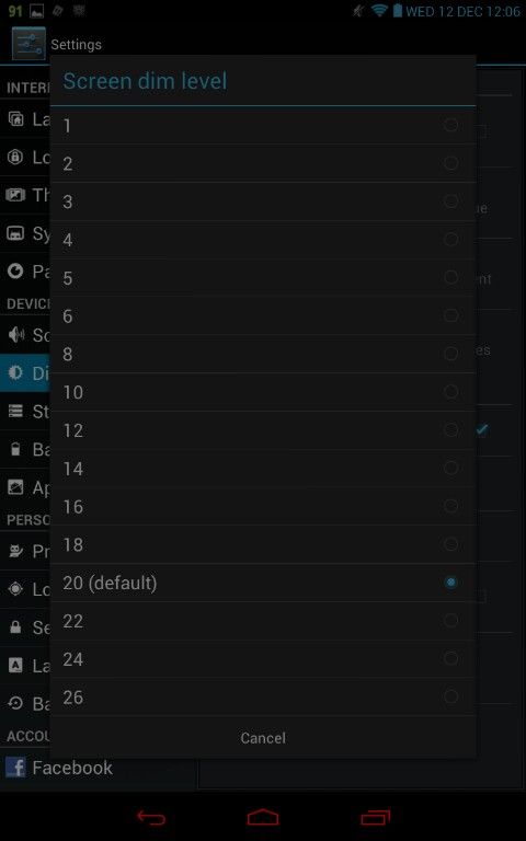

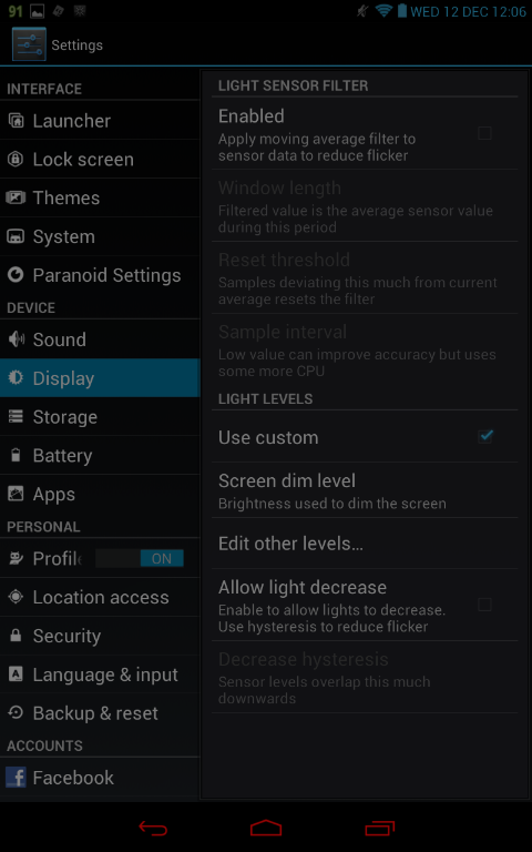

Thanks Jon,
I use arpruss' GB keyboard, too, and was aware that they're the work of the same developer. In addition to the Screen Dim customization, my ROM (Paranoid Android) also offers a wide range of screen-dimming options. Following is the first-level display settings menu (first level is Automatic backlight). When I select 'Use custom,' I get the 'Edit other levels' option. Posted Image
Next screen captures show the Paranoid Android screen brightness range.
