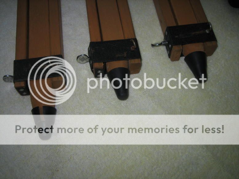

Love to give it to you Neil, but I've taken it apart to components and not found a single mark (other than the casting "gates", of course). The Cramer motor has a data of 9 77.
The exact same kind of counterweight is here, sold as an Edmund, but it didn't match anything Edmund.
Yes sir. One has a "1", the other a "2", they are otherwise identical and match the rest of the mount.
Do you have any more info on anchoring down the mount ID?
Only an absence of information. That is, all the marks on an Edmund mount, every last one of them are gone, yet the dimensions are exact to the castings of an Edmund.
I believe the mount you pictured is for a 6" reflector.
Yes sir, a 1", like the 6" sold by Edmund, down to the same mounting hardware.
My Edmund 8" is a monster brute compared to my 6".
The 6" has a 1" diameter counter shaft, and the 8" is 1.5" diameter.
Exactly. The 8" it came with is a home built with an f/5 mirror. I had speculated it might have come from Edmund, but there aren't the usual marks, and it isn't coated by Pancro. The cell was an Edmund.
The reason I'm bringing this up here is the Anchor connection.
When I measured the radius of the saddle, its for a tube diameter more appropriate for a 4" scope than an 6".
I often wondered if the 1" mount was what the Anchor 4.25" scope had originally - would have made it rock solid. And then perhaps they came up with a "discount" mount later.

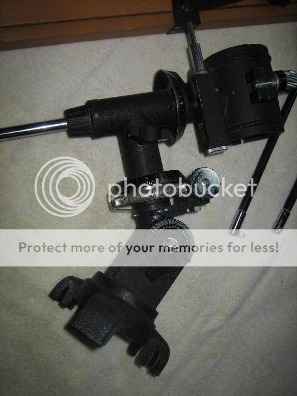

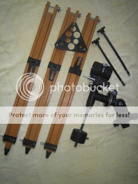

Ok, so I got this new tripod and mount that I plan to use with my Edmund. It needs a little bit of work, but I don't think it's going to be too bad. The main thing I need to do is take apart the EQ mount and figure out why it's so snug. Also, the DEC axis binds when I try to rotate it in the clockwise direction. (I'm guessing there's some sort of cam in there that's too tight.)
Am I going to have to grease anything upon reassembly? If so, what type of grease should I use? (I have white lithium grease, and other grease too... in my bicycle tool box.)
If there's anything I should know before I take this head apart, now would be a good time to let me know. :)
Anyway, here are some pictures:

The mount likely sticks due to old, gummy grease. Clean it thoroughly, and replace with Mobile 1 Synthetic Grease. It's perfect in cold climates, because it works low temperatures.
The open worm gear must be coated *not* with the Mobile 1. Use dampening grease to prevent backlash. Someone should pipe in about the right brand and weight.

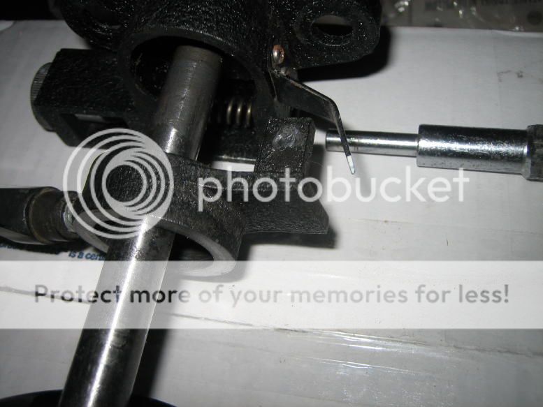

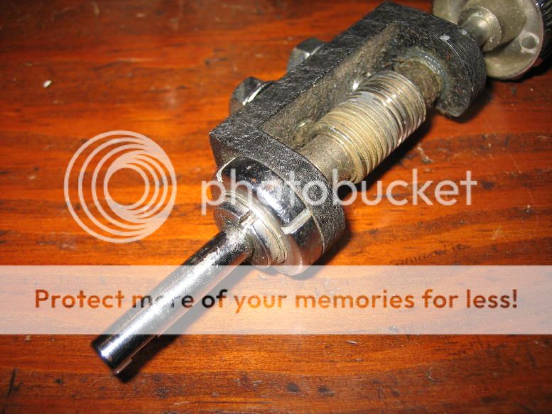

I got it almost completely taken apart. The old grease is all gummy. I don't have any of that Mobile 1, so I'll clean everything up and then sit tight until I get some. (I can't use White Lithium Grease?) I assume it's ok to take the old grease off with acetone. I don't see how that would hurt anything, except for maybe the rubber gaskets which I won't clean that way.
I noticed that the RA's exposed worm gear was being run dry. Is that a problem? I'd rather continue to run it dry, if it won't hurt anything. That way I won't get grease on my hands every time I touch it! If I use grease, what type of grease should be used to prevent backlash?
I'm not completely sure how the Dec slow-mo works yet. There's no worm gear. It's got a spring loaded mechanism. Maybe it's got limited travel. I'll have to take a closer look at it tomorrow. Whatever's going on, it seems very strange.
I haven't taken apart the RA slow-mo stuff yet. It needs to be taken apart too. It's sticky. The correct tool to use would be a small spanner wrench, which I don't have. Hmmmmm! I might be able to get it apart with a pair of vice grips and a paper towel used for padding. (I don't want to take a screw driver and whack it!)
Dec slow-mo:
RA:
#43 TahoeNoob

Does it have to be Mobile One, or is any motor oil ok? How about the weight? Doe it matter? I'm also still waiting to find out what type of grease prevents backlash, although I'd like to avoid putting grease on exposed parts, if I can.
The mount is all cleaned up. All I have to do is line up my lube, and I'll be ready to start reassembling.
