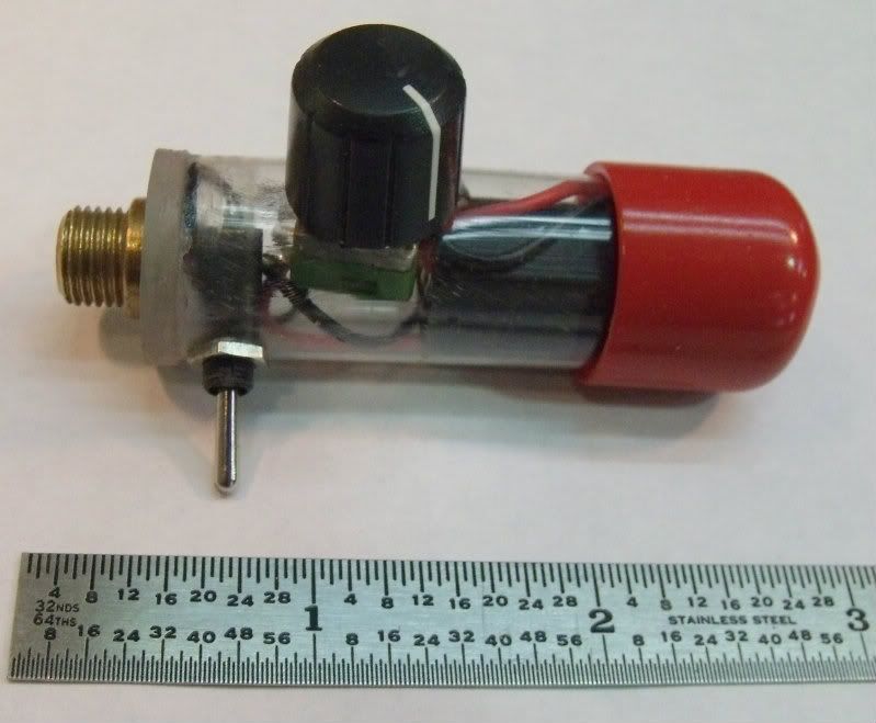

DIY reticle illuminator. The junk bin strikes again! Plastic tube that used to hold an end mill. Air fitting end. Potentiometer from broken audio compressor.Mini switch and battery holder from the Shack.

I've oft wondered what thread was used on these things. I'm assuming by "Air fitting end" you are using a fitting used to connect air hoses or such? Or is it a Schrader value?
If so, Schraders come in two threads: metric are 7.7 mm OD, thread root diameter is 6.9 mm × 0.794 mm pitch and imperial: 0.305 in OD, thread root diameter 0.271 in × 32 tpi (which really appear to be the same thread).

Its a very small 12v battery and the current draw is tiny. We'll see how long it lasts. As for the thread...havent measured it yet, but no prob. Im modding a 25mm Kellner (or erfle) to take the illuminator and an etched glass reticle; Ill just drill a hole and tap it to suit.
