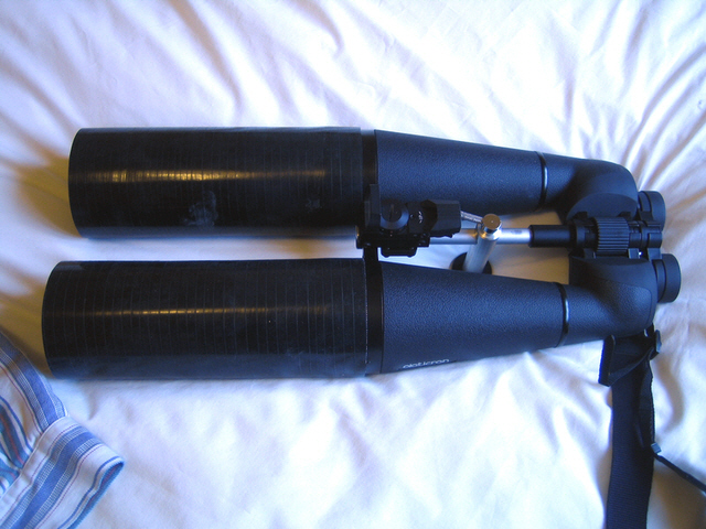

I recently bought a pair of Opticron 16x80 WP Observation Binoculars, but rapidly found that I needed dew shields.
I think I have found the perfect solution in the form of automotive silicone rubber tubing. I bought two 250mm lengths of black 90mm diameter silicone hose from eBay vendor mrsilicone as it was *lot* cheaper than from the website at GBP16.92 including P&P (almost half the price).
I thought 250mm would cause vignetting, but I don't see any indication of that at all.

perdrix, how much do the silicone tubes weigh, and could you post a photo of them fitted to the binoculars?

The tubes each weigh slightly over 1lb. (468 grams).
I tried to upload a picture, but even at 640 by 480 it was 211kB and was rejected - Grrr.
I've put it on my website:
Oh yes, the black thing fastened to the central rod is a "red dot" type reflex gun sight attached to a barrel mount type Weaver/Picatinny rail.
