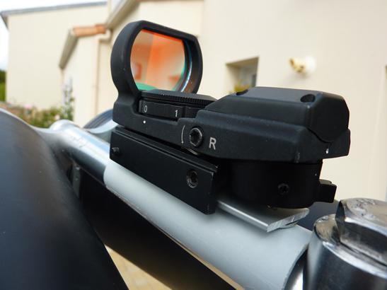

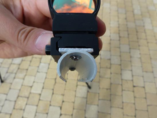

And what about some ATM/DIY stuff ?
My system with a red dot finder :

Posted 05 January 2013 - 11:33 PM
Seated viewing demands the finder be as close to the eyepiece sight line as possible.
A low profile setup like Smith shows above is ideal. I roll the taller UA adapter over to one side against the bino barrel to make an easy sight line when viewing from my recliner with a p-gram. Eric's anecdote with a bino-chair demonstrates the need as well.
This is where, when possible, the GLP shines as a finder because you're not forced to align yourself with a finder at all. ;)
Rich
