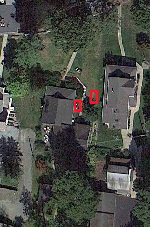

Coincidentally, I was just showing the Google overhead view to my parents. I put two red squares in there to show you the spots.
For scale, there is a golf cart in the front yard. It is 8' long.

Which direction is South, on this image?

My bad. South is down.

No problem :) Yes, that would be the best way for the roof to roll off; however, it looks like your southern view will be blocked considerably by the buildings.

I'm guessing South is at the top? Hard to figure out the lot lines on anything but the right/East side. Is that your driveway on the NE corner? Will you get a lot of light from the house to the right? Just checked your post and I'm backwards. Based on the image/orientation you're going to have a view of a pine tree and the house to the south. Your horizon will be maybe 60 degrees?

In the summer, there is a lot of light coming from the neighbors house on the left side. They have lots and lots of bright landscape lighting. There are very few winter residents, so it will be very dark in the winter.
The very top of the picture is the lake. The building at the top is a boathouse. Everything slopes towards the lake.
I will not have a great horizon, butI think it will be better then 60 degrees. It is much darker then where I typically image from. And I think most of my targets will be high in the sky when I'm imaging them.

Where is the lot line to the left of the house?

6 feet from the house. There is no room on that side.
