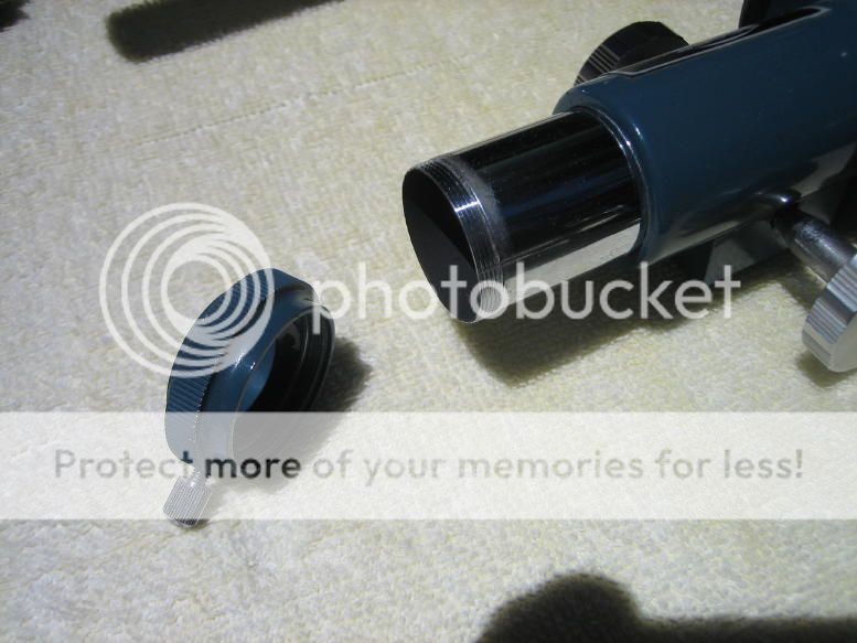

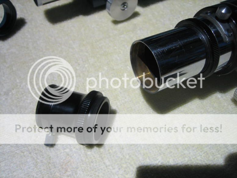

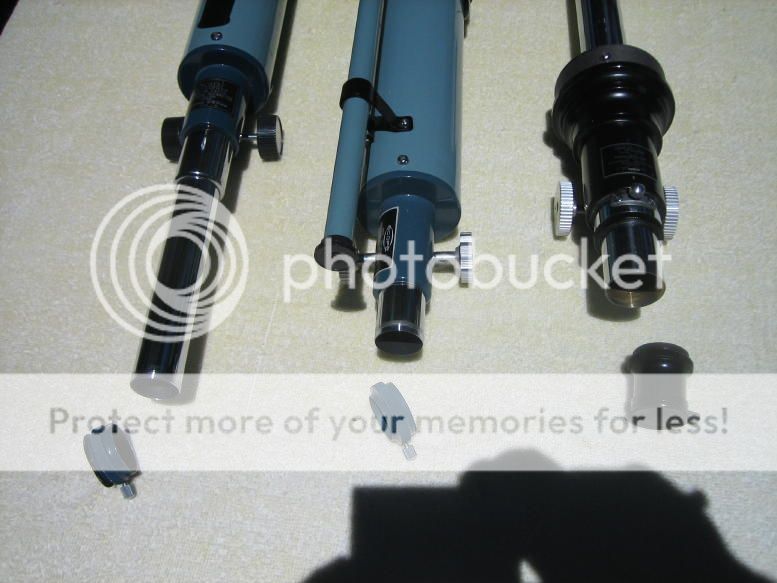

I have three classic scopes that take 0.965" eyepieces. I'd like to be able to use 1.25" eyepieces in them. Two of them have male threads on the focus assembly, and one of them has female threads.
I believe I can use THIS adapter on the female threaded focus assembly. Does anybody know where I can find an adapter to use on the male focus assemblies? (I'm thinking that I'll be using diagonals on these, if that makes any difference, and obviously I'll need to be able to focus when I have the adapter installed.)
From left to right: Sears 6335; Scope 2531; Sans & Streiffe 618

Not sure why those images are no longer showing. I don't think I moved or deleted them.

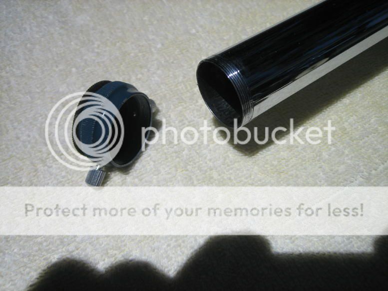

Ok, so I ordered a Vixen adapter ©, so I'd be able to use 1.25" eyepieces. The problem is that the adapter doesn't fit the end of my drawtube (B). Instead it fits onto the back of my focuser. (E)
I'm flummoxed! If anybody knows what adapter I need, I'm all ears!
