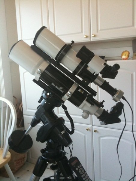

On my sample of the SkyWatcher 80mm ED, the focuser (shown in the picture) slipped, when pointing at zenith, with a Nikon D90 attached. Additionally, the focus lock would cause so much movement when engaged, I'd lose critical focus.
I had to replace it with a WO, shown here ...

It "was" just a simple WO drop in replacement; literally took less than 5 minutes to install. It too shifted when the lock was engaged, but I was able to increase the tension to the point where locking wasn't needed. Remember, a traditional crayford lock just applies pressure to the tube via the lock screw, so shifting is pretty common to the design.
I learned my lesson with that rig, one of them I mentioned before. If I were to upgrade a focuser again I'd go with a Moonlite. It's worth the extra money and if you go non-motorized, they've solved the lock shift issue with their design.
