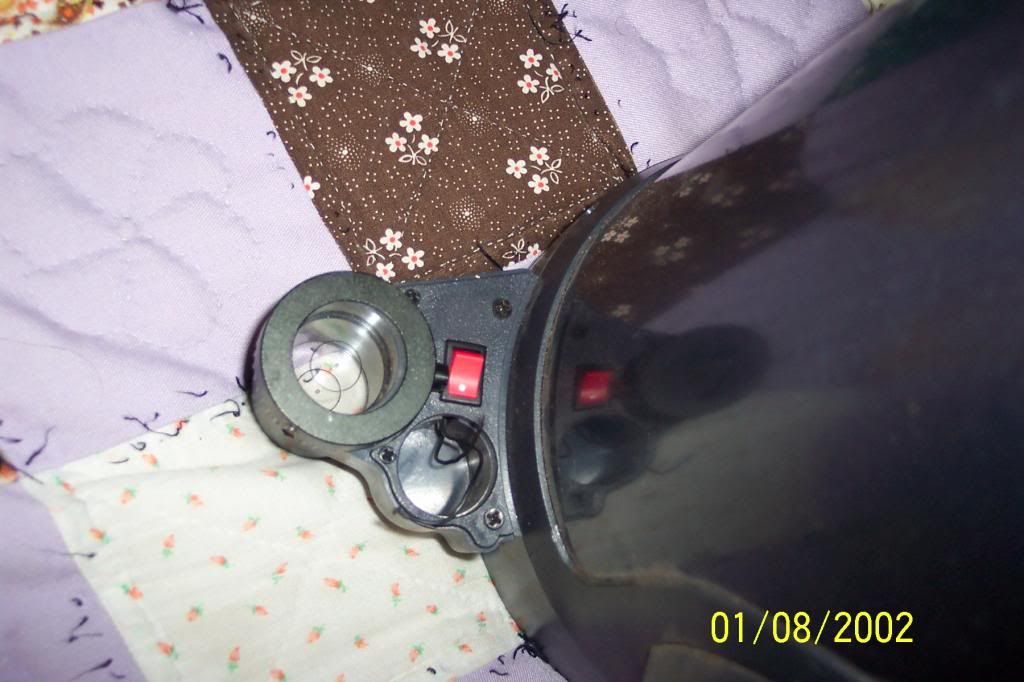

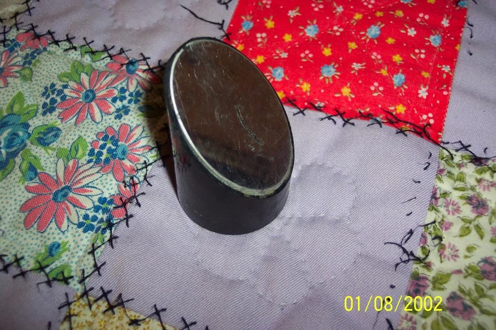

Notice the scratch. I think I am missing whatever part that goes between this and the scope.
The view finder is toast. The cap and battery holder is gone. Upgrades??

This is an astromaster 130? It might be best to send this one onto the great OTA in the sky and replace it with another scope. Sometimes, its best to just let them go peacefully.......
#12 steve-in-kville
steve-in-kville
  • Posts: 272
  • Joined: 24 Dec 2007
  • Loc: Pennsylvania, USA
Posted 25 January 2013 - 04:42 PM
Yeah, I am already looking at a new scope. Either another 130 or maybe downsize a bit to the 114.
So you're saying this one is beyond repair? At least the tri-pod is in good shape...
#13 Jon Isaacs
  • Posts: 52795
Posted 25 January 2013 - 06:53 PM
s gone. Upgrades??
Steve:
Is this the secondary mirror?

#15 Jon Isaacs
  • Posts: 52795
Posted 25 January 2013 - 08:03 PM
Not really sure what its called.
Is it about 1.5 inches in diameter and belongs inside the OTA facing the focuser??? The secondary is positioned so that you look through the focuser and see the primary mirror. Every Newtonian has a secondary mirror.

#18 Geo.
Geo.
  • Posts: 3594
  • Joined: 01 Oct 2008
  • Loc: Upstate NY
Posted 26 January 2013 - 11:53 AM
Yeah, that's the seconadary in it's holder. Think there'd a 6mm screw about an inch and a half long that holds it in the spider. Might be a spring involved too. Is the spider still in the open end of the tube? Probably should replace/recoat the mirror, but I've used worse. You can get a set of optics for these scopes on eBay for $30-40. Guess a fair number of these tubes get badly dinged in shipping. Look at eBay items 360571631032 and 370733796460. I've got one of those reddot finders somewhere.
