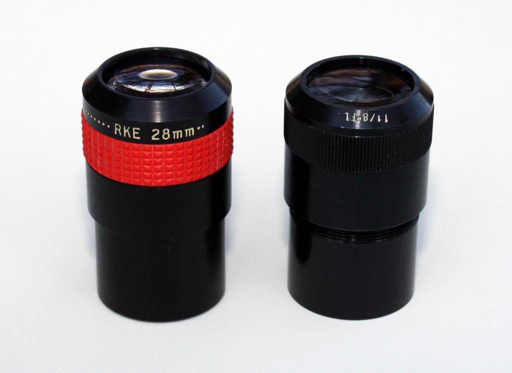

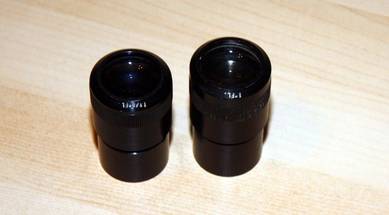

The Pre-RKE's are actually asymmetrical Plössls similar to Clave's, and I find I prefer the Pre-RKE views over the RKE:
I was even able to snag a 1" version on the bay, it has the same lens arrangement as the 1 1/8"
Jaimo!
