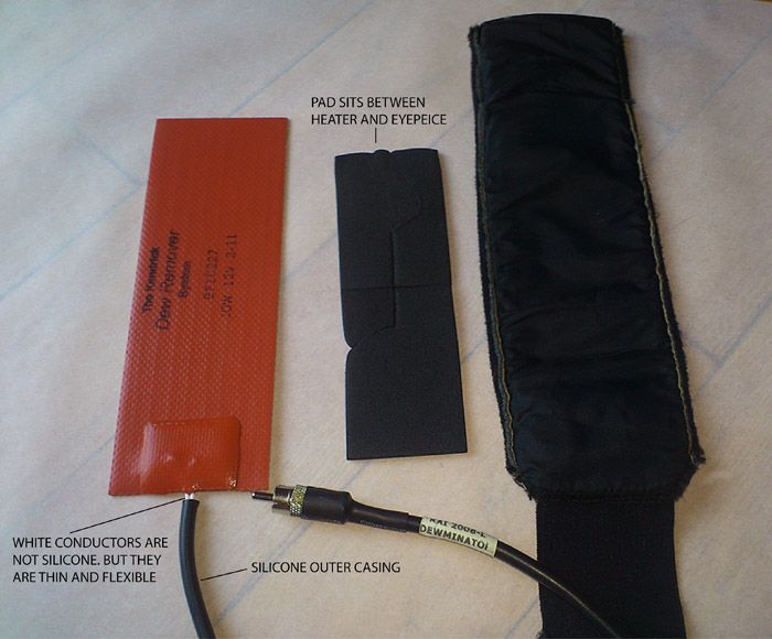

A picture is worth a thousand words;
The weakest link might be the interface between the conductors and the element. HOWEVER, looking at it carefully I see that the wire insulation is imbedded a good half inch into the rubber and NOT the typical weak solder point we see so often on electrical things. I've been using this one for two solid years and it's still in pretty mint shape (apart from the fact that I took it apart).
#13 Daniel Guzas
Daniel Guzas
  • Posts: 733
  • Joined: 20 Nov 2010
  • Loc: Bethlehem NH/ Boston MA
Posted 29 January 2013 - 12:05 AM
Zippee
Thanks for the photo! I am very much looking forward to getting the heaters so I can have my eyes close to the eyepieces while in the cold.
