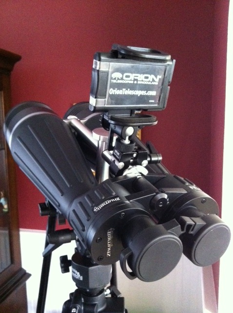

Here are a couple of pics that show how I mounted this device up to my Zhumell 25x100.
Atom clamp with ratcheting lock nut (it has 3/8"-16 and 1/4"-20 threaded holes on top), and mini-ball head from B&H:
Assembled and mounted to the center bar of the binocular - works great:
