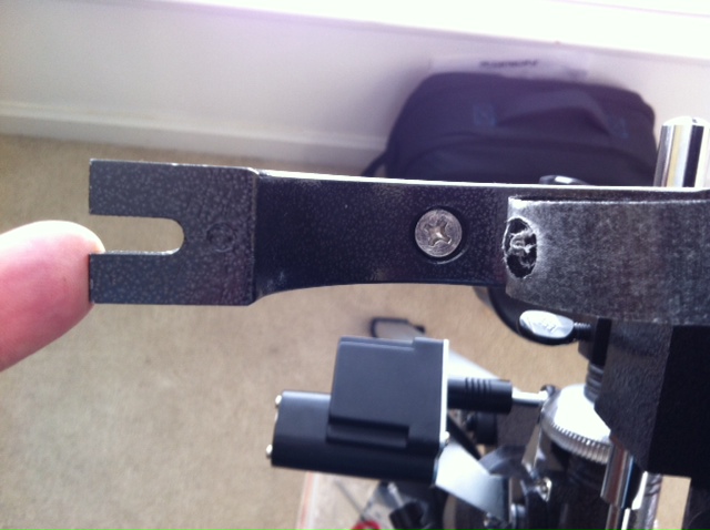

I played with this some this morning. Yes, this is not a very secure post. After manipulating the mount and trying to get it really tight, the threaded rod can become loose in the ring at which point all bets are off. I expect this is what txairman experienced. If you pull the felt tape off the inside of the scope ring, you can see how to re-secure the threaded post to the ring. I'm going to back mine out and use thread lock compound to help keep it secure:
Also, I found that using a mini ball mount does help. For some reason it is easier to secure the ball mount to the scope ring than it is for the camera. Also, it entirely sidesteps the issue of loosening the post from the scope ring, and/or the camera when you adjust position, because the ball mount (at least the one I posted above) spins freely about the locked post when you free the ball to adjust the camera.
