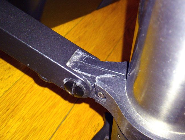

My wife cracked the spreader clamp on our tripod the first week we had it. At the beginning she had a hard time because of the bulk and would often collapse the legs unevenly. I couldn't really care less and would never hold it against her. Two years of flawless operation since.
I'm a materials engineer and I work in machining. There is a very obvious stress riser in the design. These types of plastic components are typically investment or die cast with inexpensive materials. I was thinking about making some new ones out of a more resilient plastic but because it's been working fine . . . meh, I have better things to do.

Zippeee,
the damage your picture shows looks exactly like my (two) cracked clamps.
This was the purpose of why I originally posted: to see if others were having similar or identical problems with their clamps/tripod.
Your post confirms a design flaw. But, like you said, the overall quality of the scope outweighs what I see to be a relatively small problem -- but a problem nonetheless.
