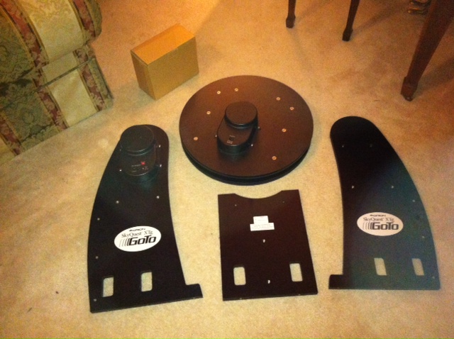

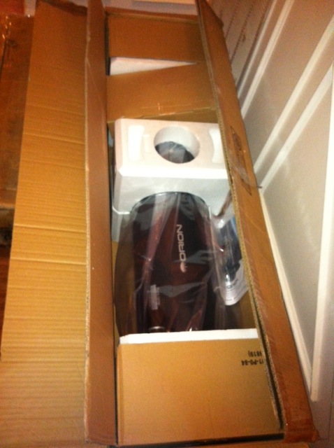

A couple unboxing pics:
Contents of the smaller box:
A peek inside the OTA box:

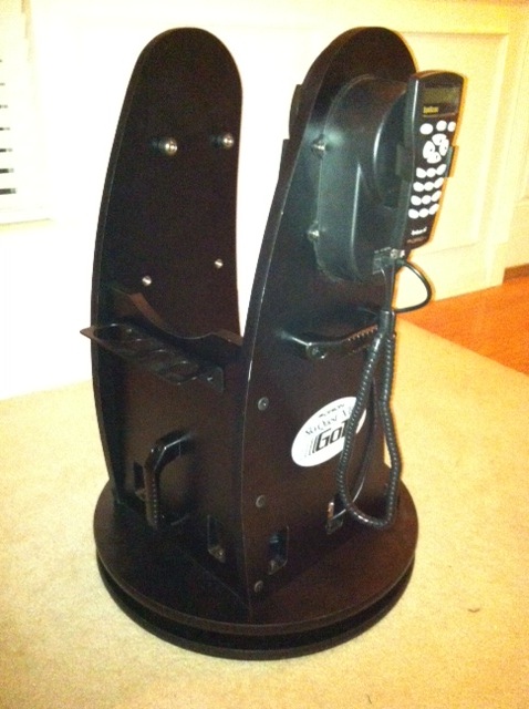

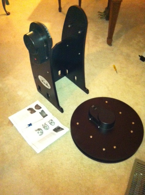

Base assembly was remarkably easy. Very impressed with the overall quality of the parts and precision of the hole placement, etc. Can't remember the last time I assembled something of this size where all the holes lined up perfectly with no fuss.
#9 Jarrod
Jarrod
  • Posts: 1288
  • Joined: 20 Jan 2013
  • Loc: SE USA
Posted 06 March 2013 - 12:43 AM
All done! Now what? :cloudy:
