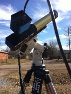

I use the iOptron SmartEQ for my PST. No issues at all. I just point to north with a compass, estimate my local deviation, and turn it on. Slew to the sun, sync target, and no further fuss. Can be setup up and viewing in a couple minutes. I have no doubt it will handle the Lunt 60 with ease.
