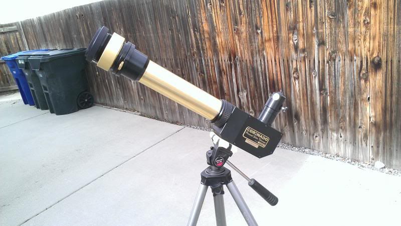

Mine arrived today. I usually mount the PST on a GEM, but a tripod works well for low-power, quick views. Except of course it was too cloudy to use it! Clouds and rain forecast for the next four days. !%*@#!
Also the etalon cell blocks the sun finder, that was a surprise.
