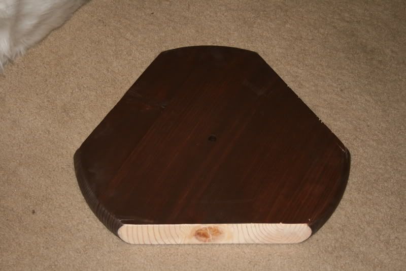

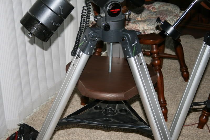

This is what I did to stabilize the tripod. I bought a wood bar stool seat at a big box lumber yard. I cut off 3 pieces at an angle roughly the same as the tripod legs sit. I drilled a hole in the middle. I removed the bolt that holds the head onto the mount. I replaced it with a piece of threaded metric shaft, a couple of washers and wing nuts. I threaded the shaft through the tripod and into the head and then used a flat washer and wing nut to tighten it up. Then I slid the spreader on the threaded shaft and use another flat washer and wing nut from the bottom to hold the spread firmly against the legs. It may sound like a lot of work, but it's only a few hours work and well worth it.
If your not mechanically incline, don't even consider it.
