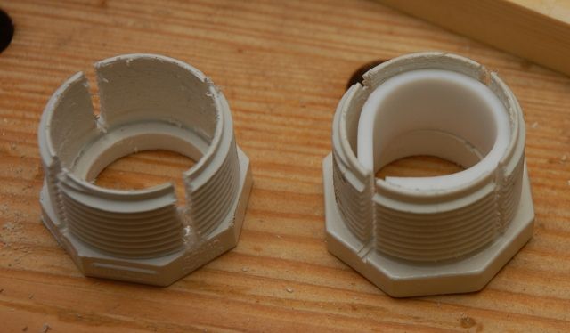

I've implemented the changes DavidG suggested for his Delmarva mount system. The mount now utilizes some PVC reducers and Teflon to provide better bearings.
The first step is to modify the PVC 1-1/4" to 3/4" bushings. The 3/4" side needs to be bored out using a 1-1/8" Forstner bit so that a 3/4" galvanized pipe can pass through it.
Next, the 1-1/4" end needs to be bored out to large enough so that the 3/4" pipe with Teflon wrapped around it can fit. I used 1/8" thick Teflon which required me to bore bushing out to 1-3/8". I did this on the lathe as it is easier to find the center of bushing. When boring the bushing you want to bore down only as far as needed so that a shoulder is left in the bushing to keep the Teflon from sliding out.
The thread on most plumbing pipe is tapered. This can be used to our advantage to increase or decrease the friction on the bearings. If the bushing is slotted as shown below, as it is tightened it will bend in pushing harder on the Teflon and pipe. The bushing on the right has the Teflon bearing material installed.
To use the new bushings I had to redesign the mount. Some of the parts are still there but I’ve added a few new pieces. Instead of pipe threads acting as bearings on each other, 3/4" galvanized pipe is held by the PVC and Teflon bushings. The 3/4" pipe is threaded into a 1-1/4" to 3/4" galvanized reducer and the whole piece spins.

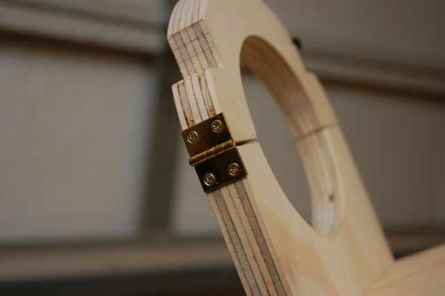

Previously to get the scope rings apart I had to remove four 1/4" nuts. To speed this process up I put small hinges on one side of the rings.

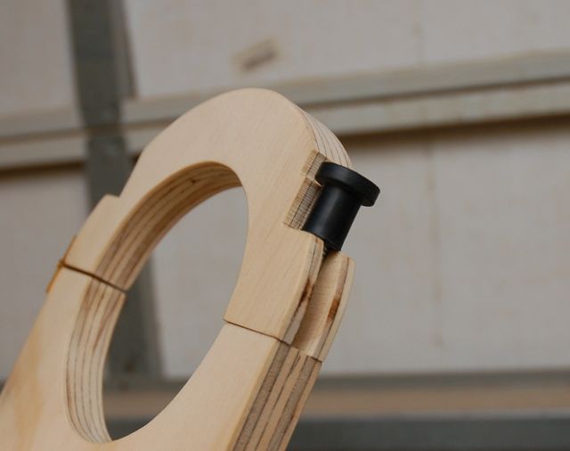

On the other side, I put some well nuts. I stumbled upon them at Lowe’s and they work well for this purpose. They’re made out of rubber with a 1/4" nut set into the bottom. They’re easier to get a grip on than the hex nuts.
Viewing with the scope is much improved over the previous design. The scope now turns smoothly and stiction is pretty much nonexistent. On the downside, the mount gained another 2.6 lbs bringing the total weight up to 41 lbs with scope and counterweight. This was definitely a worthy modification though.

Great job, and glad to see that the Delmarva Mount worked well for you as well. I'm a little surprised that you had to bore the back side of the reducer out for the Teflon. I used a couple of different thickness of Teflon when I developing the design and all worked well without any boring of the back side of the bushing. I just cut the length of the strip of the Teflon so it would fit inside the bushing when it was bent into a ring and had a gap in the end so the Teflon could have remove the move as it was squeezed down around the pipe. The taper of the pipe thread gives a wide range of how much it can be screwed into the piping fitting, offering a simple way to compensate for different thickness of Teflon, within reason. I designed the system so that only simple hand tools are required to make the bearing. One could, for example uses a file to just remove the threads in the bushing so the 3/4" pipe would slip through. My goal was a system that worked very well but also kids or someone with the access to power tools could build.
