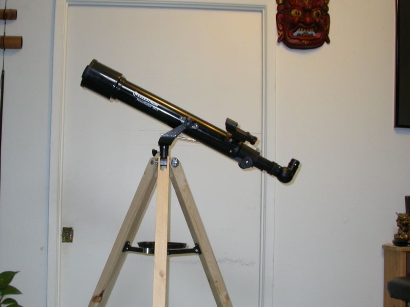

I bought a Powerseeker 70 a few years ago for $40, mostly to get a idea of what was possible with it. If you are willing to do some handy work, you get a pretty decent scop for your $40...
This is the story of my Powerseeker 70..
A short summary:
- As is usual, the mount is a problem, shaky and prone to vibration. For a few dollars and a little handiwork, new tripod legs can be fabricated and this makes for a much more solid mount.

Since you are willing to purchase used, I suggest expanding your horizons, with a careful eye and enough time, something better than either the Astromast or the Powerseeker is likely to show up in your price range...
