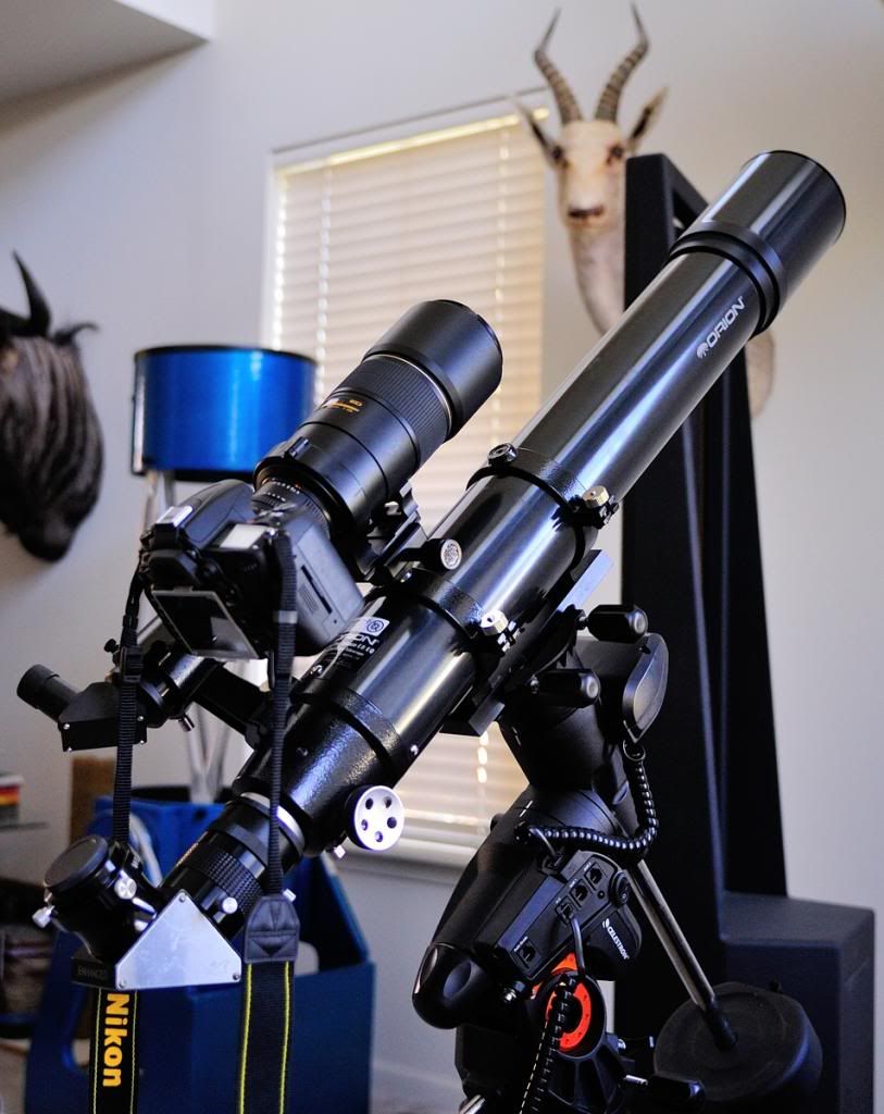

So, please tell me, do you just piggyback the DSLR to the scope on the mount with one of these lens and have at it?
I do both. When I first started in AP I used a CG-5 mount (the predecessor that your AVX is an improved version of) and a camera alone, I had no scope to image with. These days I quote often run two cameras, either two camera lenses or a telescope with a camera lens piggybacked.
For direct mounting (without the scope) all you need is a dovetail bar with a 1/4-20 bolt set into it. There are a couple of sources for that, the ones I am linking are from ADM accessories - not the cheapest, but very nice high quality stuff. One nice way to do it is with the CDUP7-CM part here (second preview image) as that combines a nice stiff 1/4-20 mount with the dovetail. Alternately you can just get a dovetail by itself and supply your own tripod head. Perhaps the 4" or 7" bar (check how long the saddle of the AVX is - you want the bar to be slightly longer then the saddle so you can shift it a bit for balance adjustments). If you get the bar by itself email Anthony (the AD of ADM accessories) and ask about including a 1/4-20 mount bolt with the bar - I have found Anthony to be quite easy to talk to about minor things like that when I have ordered parts from him in the past.
For cheaper options check out Orion and ScopeStuff, they have some dovetail and/or camera-mount options buried in their selections (as do other sources).
For piggyback that depends on how your scope is setup up. I have a second dovetail bar on the top end of my scopes and then use the VCM version of the camera mount to connect the scope. In this shot here you can see a Tair-3 300 f/1.4 piggybacked in that way on my AT6RC scope.

My 100mm Apo has rings that are drilled and tapped for 1/4-20 on the top. My 300mm lens has a lens collar and I have a Feisol QR plate on it. I'll just buy another Feisol dovetail and screw it into one of the ring 1/4-20 holes.... done!
Sounds good. If you find the 300mm is to heavy and the rings want to shift then a dovetail bridging the top of the two rings will give you extra stability.

I got the Nikon D7000 with the 300mm f/4 lens piggybacked on to the 100mm apo today....
