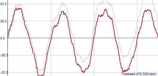

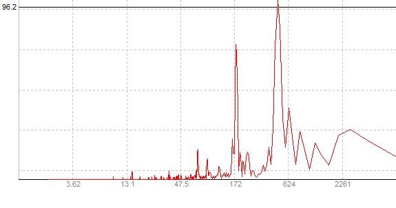

The graph shows the 8/3 error 75% of the PE. The PE curves repeat each 3 worm rotation because of the 8/3 error. That means the PEC can not be relied on to reduce the PE past the 8/3 error. In fact it may add to the error at certain places in the worm cycle. If my 8/3 error were not so great and abrupt the mount would guide much better.
This data was collected at a very light load (12 lbs), when the load is increased by using the C11 and guidescope the PE runs around +-20 arcseconds with the 8/3 being just a tad more than the 75% seen here but much harder to control. Celestron has stated they believe the average CGEM/DX has an 8/3 error that runs no greater than 10 arc seconds and should be less than 5. There have been user reports of 8/3 error exceeding the integer harmonic however.
These are the thoughts on the 8/3 error by Celestron in reply to a conversation with a Celestron engineer on the teamceleston site;
"First, the 8/3 gear. Probably 90% of the customers that buy a CGEM do not even know what PE is, much less how to measure it on their mount. Of those 10%, that know about PE, most of them (mistakenly) believe you can't/shouldn't use use PEC with an guide scope, or at the very least wouldn't see a benefit from doing so. For them an 8 arcsecond term that varies over 2.5 minutes is easily guidable, smaller in fact than some of the other non-periodic terms. So that leaves about 1 percent of all CGEM owners who are inconvenienced by the 8/3 gear. "
I need to add a big YMMV! :foreheadslap:

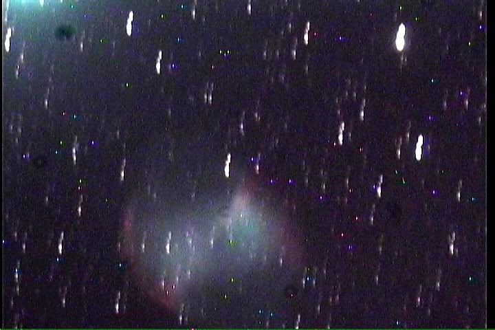

This is the PE of the first CGEM I had with an 8 lb load. With the C11 and equipment it was 180 arcseconds;
This is a 20 second shot with the C11 at 5. In all fairness this was at the worst part of the worm cycle. It could get a approx. 30 second shot with oval stars if you hit just the right spot on the worm cycle.
It took couple of tries but Celestron did replace the mount eventually and then did again when the replacement had a problem they couldn't fix. The 3rd mount is functioning quite well excepting the 8/3 error.
