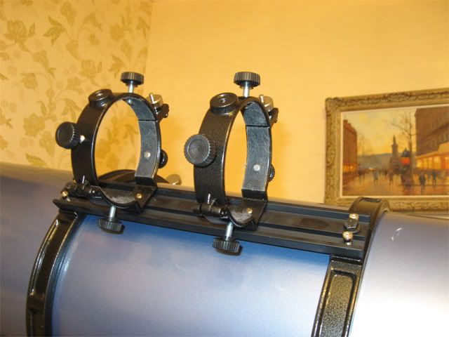

The problem I found just yesterday with a viewfinder is that my OTA has two holes to screw the actual 6x30 finder pier. This is: my viewfinder pier is not attached to a "standard" base, it is directly screwed to the OTA.
The distance between those two holes is 39 milimeters, and after looking and asking in several online shops and local dealer, the closest finder base I could find had the holes with a distance of 40.5 milimeters, so it won't fit the actual holes and I'm not drilling new holes to the OTA, so unless I find a compatible base, the viewfinder will not be an option.
Also I asked for clamp rings the diameter of the new viewfinder to attach the viewfinder to the main OTA with a new dovetail, but there aren't so small clamp rings.
So I think that a short focal, lightweight refractor mounted over the main OTA is the best option.

Ok, wait, I think I will post images of the problem.
This is how my 6x30 finder is fixed to the OTA:
And those are the holes in the OTA to scren the finder's pier:
The pier shoes commonly sold don't have that exact distance between screw holes, so I would need to phisically modify the OTA itself to adapt it to the new pier shoe.
The only option I see here is the one from scopestuff.com, http://www.scopestuff.com/ss_rdpq.htm.
The only thing I don't like about it is the fact that it is only fixed with a single screw.

I have a refractor with a single hole Vixen style base. It hold fine as the OTAs curve locks it in place. Not sure about large guide scopes though. For that I would only use scope rings mounted to a dovetail bar which in turn was mounted to the top of the main scopes rings.
Yes, the dovetail thing is what I want to do:
