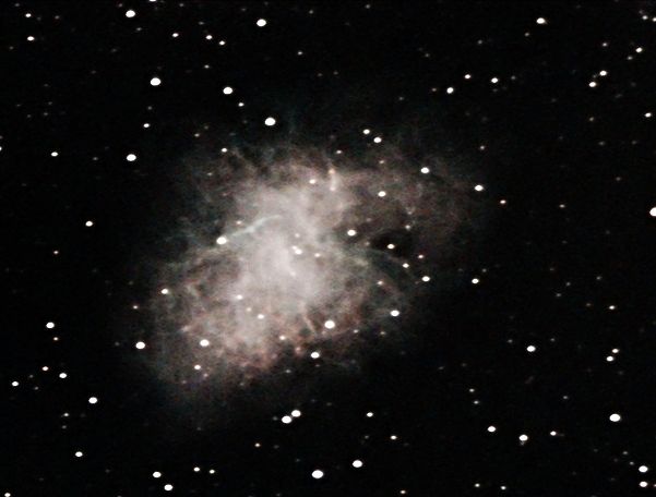

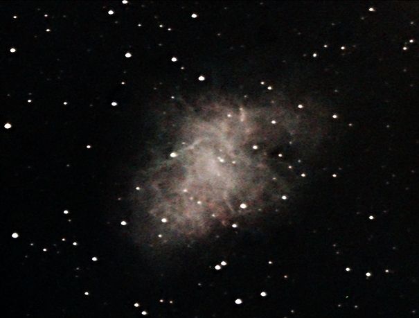

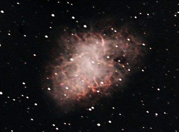

Here's 3 images of M1, all are 30 minutes of total integration. It's not a perfect comparison (different nights, slightly different conditions, different number of darks, processed as similarly as possible), but you can get some sort of idea.
Here's a stack of 10 3 minute subs:
Here's a stack of 6 5 minute subs:
Here's a stack of 3 10 minute subs:
