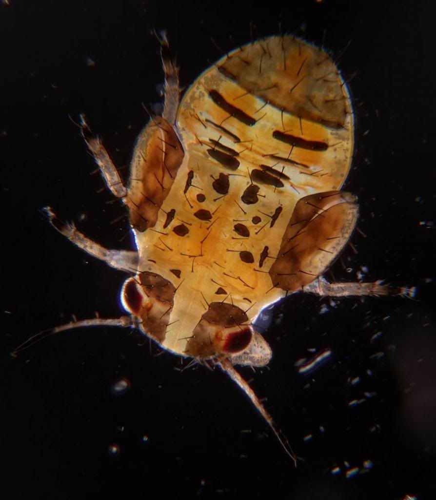

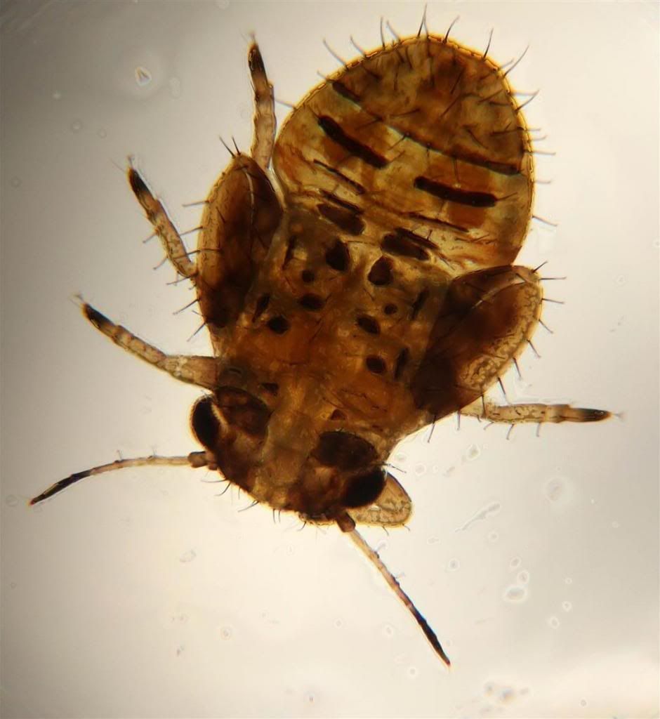

Found this guy crawling on my newspaper this morning. He's smaller than a period on the newsprint or computer screen.

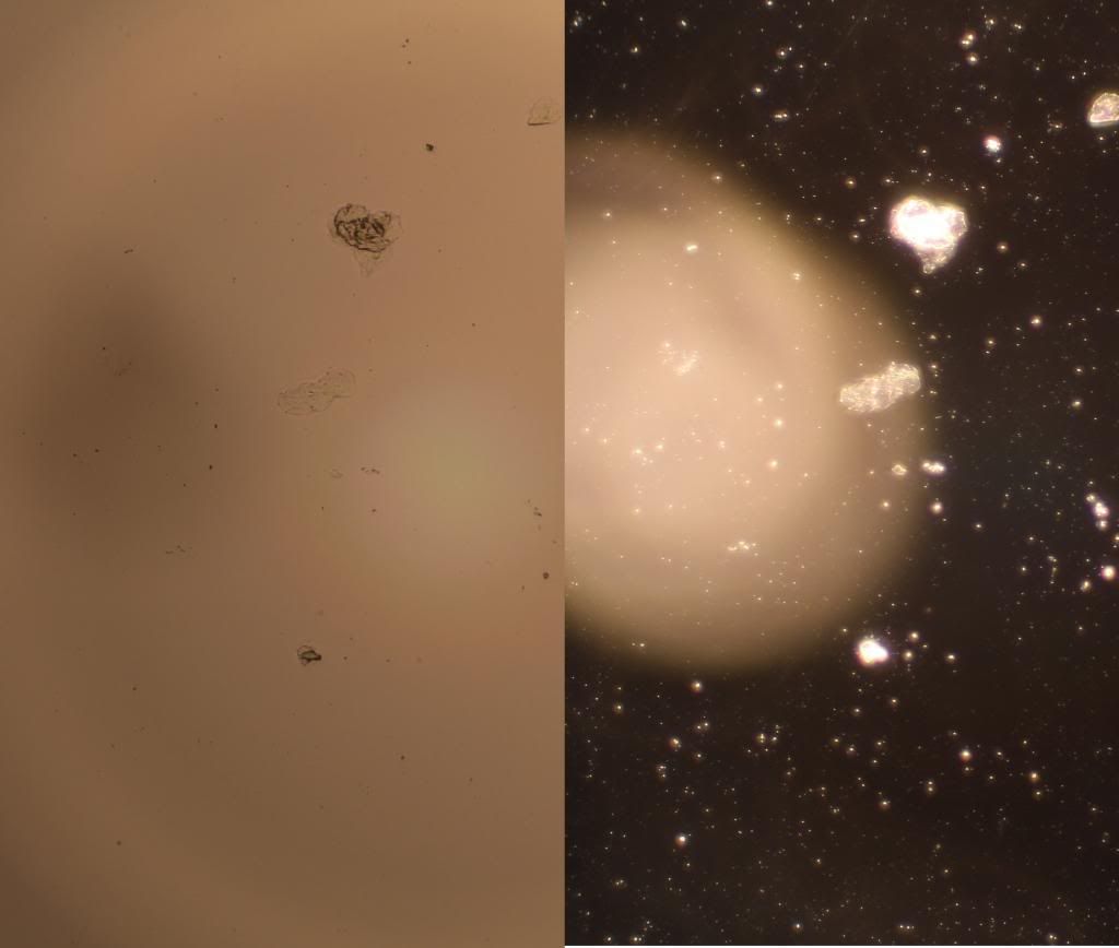

The T490A-PCT arrived, and it's unusable. The 10x objective goes into darkfield, and won't focus on my blood smear slide. The other three objectives give worse views in phase than in brightfield. I reversed the phase ring turret order, and the 10 & 20x objectives got into phase, but the 40 & 100x gave even worse views. I asked Amscope to ship a better PCT or refund my money.
Testing was done on a commercially prepared blood smear slide. Views of other slides looked fine, but they didn't have subject material that pops in phase.
Follow-up: I called Amscope, and talked to a specialist who said they can ship me a pre-tested PCT. I just emailed my purchase information to Amscope.

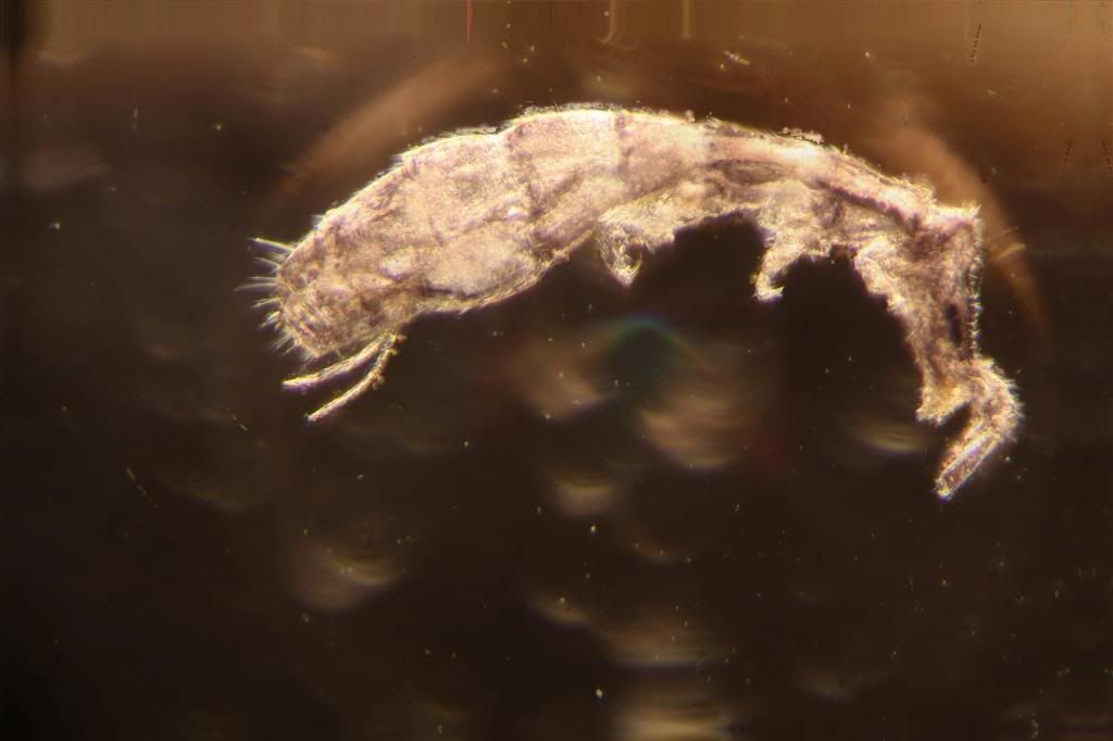

Here are some Springtails. I put some damp soil in a funnel with a small glass bottle filled with rubbing alcohol underneath. Then I drove the microscopic Springtails out of the soil with a light bulb placed above the funnel. I'll get better photos when I get an eyedropper or pipette and solidly mount them. This is 40X through the Olympus stereo scope.

I took the Springtail photos through my Olympus SZ4540 stereo microscope. I haven't critically examined photos taken through the T490, as I'm still experimenting.

More on my PCT. I put 10X achro and Plan achro phase objectives side-by-side in the objective turret, and aligned all four condenser turret annular rings with the phase objective. I compared brightfield and phase views at each condenser turret position. Then I repeated the testing with 40X achro and Plan achro phase objectives
Conclusion: The condenser turret was faulty. Positions 1 and 2 could not give phase contrast views. Phase positions 3 and 4 gave worse views than brightfield, regardless of the phase objective used.

Received the PCT this afternoon. Results just as poor as the first PCT, so I guess the problem is in the scope. I'll change the objective positions in the turret, but expect I'll be returning the PCT at a minimum, and possibly the entire combination, come Monday.

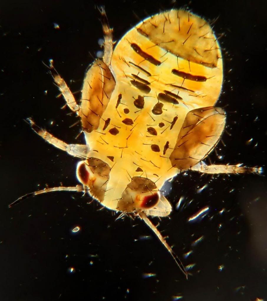

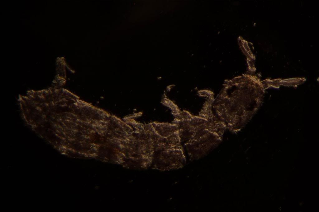

I used my stepdaughter as a blind tester. She picked the brightfield views as better every time. PCT will be returned. Perhaps the T490, too.

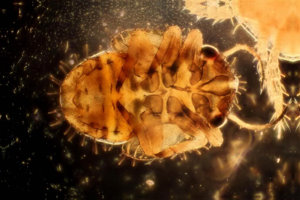

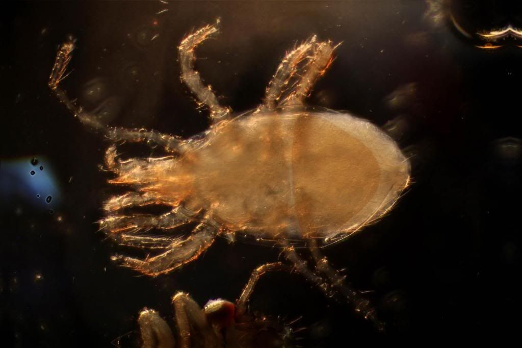

Here are some microscopic insects @200X. Springtails (1 and 2), brown mite, dot bug underside.

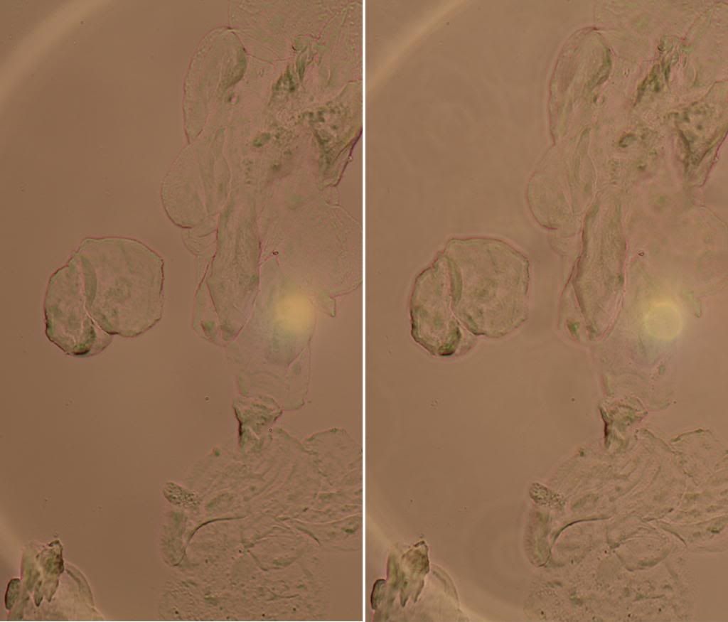

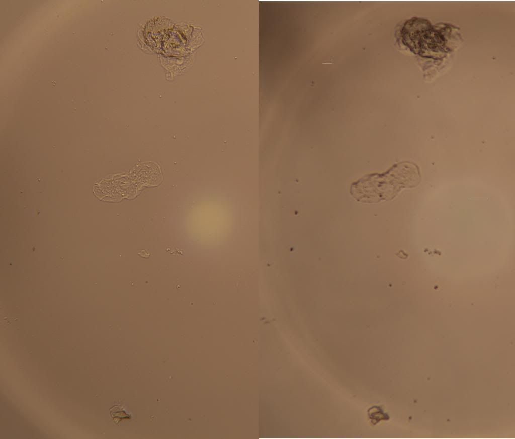

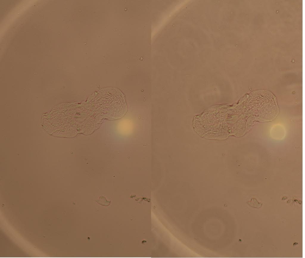

Here are some side-by-side brightfield and phase contrast views of epithelial (cheek scrapings). I chose them for their transparency and low contrast, where phase contrast should make them pop. The 100X photos show the PC view is darkfield, and without useful PC effect.
The 200X photos show the PC view is semi-darkfield, and also without useful PC effect.
The 400X photos are where the benefits of PC should be most apparent, but I can't see any improvement in details in the right side (PC) photos.
There are some focusing issues in the photos, but no fine focusing adjustments made the PC views better than the BF views. I did some blind testing with my stepdaughter (an Industrial Biotechnology major) and she unfailingly called the PC views worse than the corresponding BF views.
