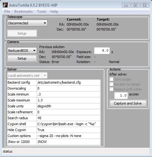

I've been using Astrotortilla and it's solving very quickly. But no matter what I set the slew until within setting, the target isn't in the center of the FOV. It is typically 1/3 of the way from the left side.
Here are my settings, my equipment is in my signature. This is using the Edge HD 800.

Try changing JNOW to J2000?

Is this at prime focus? If so maybe you have cone error in your setup.
My ed80 and C11 at f2 are spot on. The only things I would do is check you have the same Jnow set in your planetarium software. You could reduce your search radius down from 45 degrees to maybe 10 degrees. That will not get more accuracy but it will speed up solves.

I have the same issue, but mine it off to the top. Each time AT syncs and slews it move farther and farther up until it goes out of the fov to the top. AT then reports it's within 1'. This is with a canon t2i on a Meade 10" SCT mounted on an atlas eq-g.
With my 80ed it does the same except because of the wider fov, the target ends up about half way from the center to the top edge.

I was able to get this working for my mount. I had to upgrade EQMOD to version 127l from their yahoo groups site. I was on version 124g which doesn't have settings for J2000 or JNow. Once I updated I was able to set EQMOD, CDC, and Astrotortilla all to J2000. Everything is now dead center. (For some reason that I can't figure out, when all three software packages are set to JNOW it's still off though)
