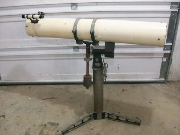

It's not bad looking from 20ft off.

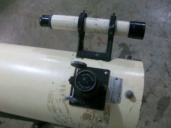

But there are some really bad spots.

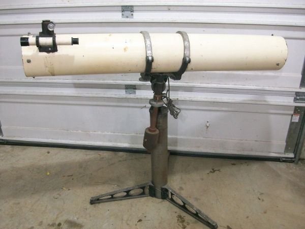

And the one thing that worries me the most.

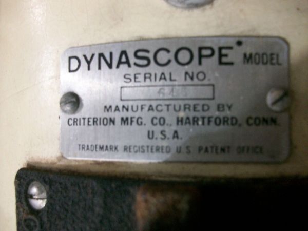

Nice! Nothing that can't be fixed up though. That tube cradle I'd ask someone what they think. Someone on here has a '59 Cave and their pier leg was snapped off and it was fixed like new. There are several different models/versions of the RV-6, and by seeing you have the nameplate it's older than 1971. Pop open the motor cover and on the motor you'll see the serial number with the date. That looks like a really fun project, I really enjoyed restoring mine. There's several people on here that know how to fix just about every part on this scope so I'm excited to see how you'll restore it!

I have a closeup picture of the serial number plate.

Looks restorable to me! Try to get that cradle repair first so it doesn't hold up the rest of the project. A machine shop should be able to weld it back together.

I've welded cast aluminum before. I'd first make a jig to clamp both pieces in the proper position relative to one another. Then I'd pack ice on both pieces leaving only the cleaned area to be welded exposed. The ice helps prevent distortion from the heat of the arc.

I've seen it done. But the welder used cold, wet rags to keep the warpage to a minimum.
