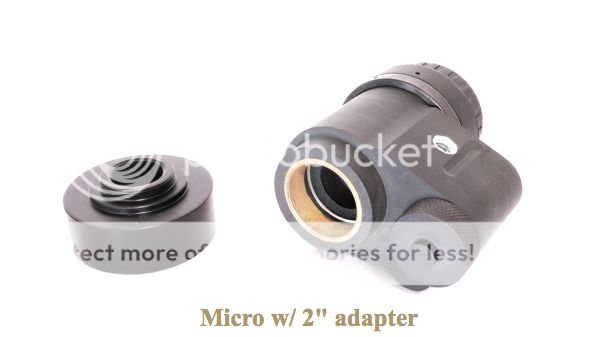

#8 cnoct
cnoct
  • Posts: 360
  • Joined: 02 Sep 2010
Posted 31 January 2014 - 01:10 PM
Wonder how hard it is to take something like this or this and convert to Astro use with 2" nosepiece?
Now your tracking and doing yourself a huge favor.
The PVS-7B/D are the premier image intensified bi-ocular device for astronomy use, wether it be as a 1x viewer, magnified or as a bi-ocular intensified eyepiece. The same can also be said for the PVS-7A/C.
For bi-ocular viewing, the above systems are what your after, period!
Adapting both is as simple as it gets, a simple c-mount adapter is threaded on inlace of the objective assembly. With the adapter in place, you'll be able to use either a 2" or 1.25" barrel adapter.
There is an exhaustive thread on the above units being used for astronomy. You'll find it here: Night Vision Binoviewers (MilSpec style)
If your also considering a monocular as an image intensified eyepiece, look no further than the NVD Micro Monocular
With the Micro Monocular all you'll need to adapt it to a telescope is a simple 2" or 1.25" barrel adapter. Can't get any simpler than that.
If you do look into any of the above, Night Vision Depot comes highly recommend from myself as well as others on this forum. They are one of two ITT Exilis Distributors and the only one with staff that understands the needs of the astronomy end user.
Image Intensified systems are best used to image at "frame rates" in the nano second range,

Cnoct, Where would I get the 2" or 1.25 adaptor for the Micro Monocular? Just to clarify{because this sounds to good to be true}would I be able to put the Micro Monocular{
with the 2" or 1.25" adaptor}into the diagonal of my CR6"
and it would work? Thanks for the patience. I have a 8079HP
on it's way right now{because that's all I could afford}but there is tomorrow. Can you recommend any filters that I could use with the 8079HP or the micro monocular?
Thanks for the great help. De Lorme
#12 cnoct
cnoct
  • Posts: 360
Posted 02 February 2014 - 04:11 AM
There are numerous sources for the both adapters, price and style are what it comes down to.
Here are a couple sources/options for you:
C-Mount Male to 1.25" Barrel Adapter
C-Mount to 2" Barrel Adapter
1.25" nosepiece to C-Mount
T-Mount and 2" C-Mount Adapter
1.25" adapter C-Mount
Just to clarify{because this sounds to good to be true}would I be able to put the Micro Monocular{with the 2" or 1.25" adaptor}into the diagonal of my CR6"
and it would work?
Yes, you absolutely could, it is as simple as changing an eyepiece.

Pictures always help as well...

Both the PVS-7B/D and Micro Monocular use the same camera adapter/mount. Ignore the Morovision branding, it's sold by many without any particular branding.
Again, both systems will accept c-mount accessories though the PVS-7 series will need an extra adapter to allow such.
