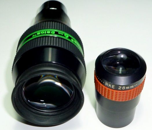

Love the RKE28mm, as a legion of others do too, it's a special EP - don't even get me started about its almost magical floating projection effect, it's one EP that's not gonna leave the stall any time soon (to view RKE28 blog post review, click here).
RKE 28mm at right
Nevertheless, the TV Panoptic 27mm remains my workhorse at the 27-28mm focal range because of the larger field and much better off-axis performance, where the RKE falls short.
TV Panoptic 27mm at bottom left

Posted 28 April 2014 - 04:26 PM
I got my 28mm RKE in the mail today. I tried it out for about 15 minutes before the clouds moved in. It works just fine in my f/4 Starblast 4.5. No V shaped stars or kidney beaning. The image was very clear. Sharper view than the 26mm Ganymede Erfle I've been using as a finder eyepiece, but the field of view isn't as wide. Works great for a low mag eyepiece at 16x. I tried it on Jupiter using 2x and 3x barlows for 32x and 42x. Jupiter and it's moons looked good too, but kind of small. No chance to try it on any DSOs before the clouds moved in. It's a keeper!
