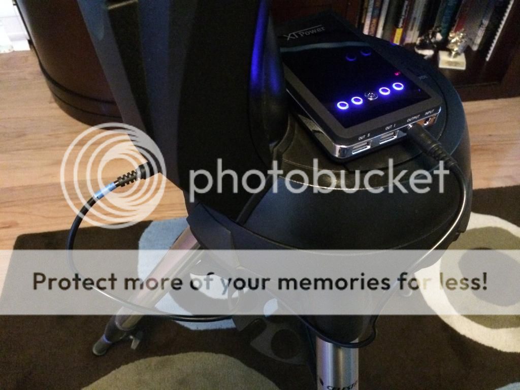

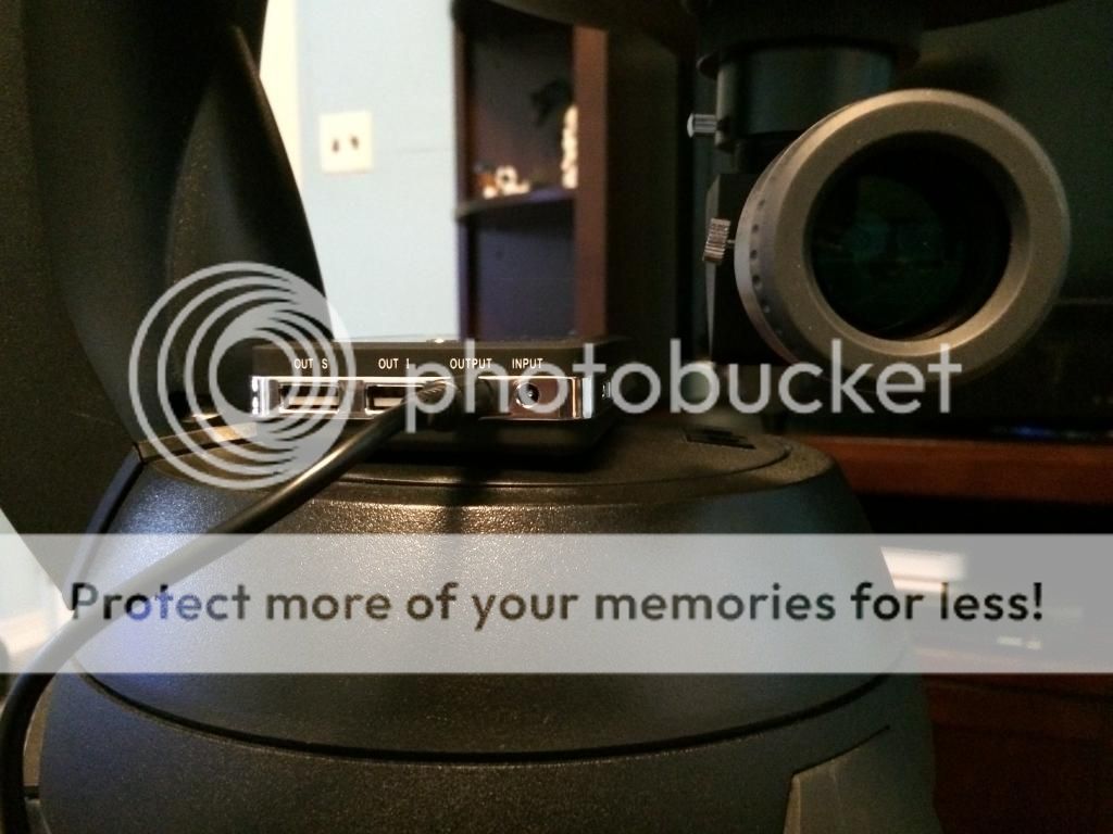

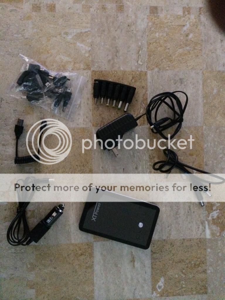

I received my package today. I charged it fully and it is ready to go. As I mentioned before it is a turnkey solution as it has a cable that terminates in a 2.1mm connector which will mate appropriately with the SE mount. The plug is rather short at 28 inches but I plan on mounting the battery over the onboard battery compartment which will rotate with the mount. I placed it in that position and checked to see if the tube coupled with the diagonal and an eyepiece would clear. It did so successfully. (See the pics below) The power bank is just a little larger than an average smartphone.
My first impression from playing with it in the house is that it supplies power to the mount as it should. However this is not a meaningful test. I will try to get out tonight or tomorrow to put the scope through some hours of use to see how this power bank holds up. It is rated at 10000mah and has 2 usb ports for charging smart phones and a dc line that is switchable between 9 and 12 volts. I switched the supply to 9v and this still seems to supply enough power to slew the scope.
The battery and a slew of power and connector options.
The proposed mounting area.
Clearance.
Regards
Sonny
