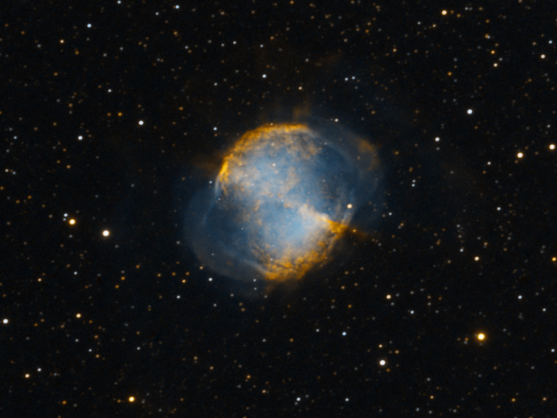

HA OIII OIII:

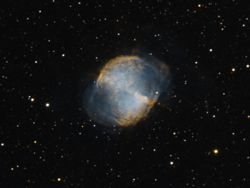

HA HA/OIII OIII:
here's a polished version of the second:

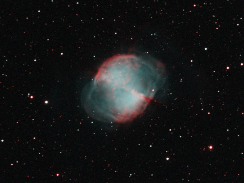

lastly, here's my RGB image from last year
http://whwastro.homestead.com/files/m27-combined.jpg

bicolor techinques HA OIII OIII vs HA HA/OIII OIII
note, m27 is a great object to try this with as there's a g0 (almost g2?) star in the field for color balance.
HA HA/OIII OIII
pros:
-better star color balance?
-emphasizes HA/OIII contrast in areas of high OIII signal, eg, center of apple core
-boosts dim HA areas
cons:
-undersaturated, red stars a bit yellow/orange
-deep reds turn to orange
-misses color contrast in low OIII areas (eg, the wedge, HA periphery)
how to compensate for shortcomings:
-increase saturation
-use the difference between HA and OIII as a mask to further increase saturation
(returning the contrast of the wedge)
-apply the HA OIII OIII version using the HUE or color combine technique in PS
to bring nebula colors to more traditional appearance.

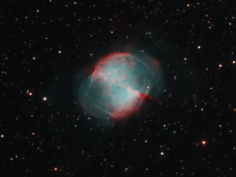

HA OIII OIII
pros:
planetary nebula color comes closer to my RGB image.
great color contrast with deep red in the wedge,i.e., areas with high HA and low OIII.
boosts dim OIII areas
cons:
red stars too red, slightly oversaturated
HA signal in center is overwhelmed by bright OIII signal
and detail/contrast is lost as everything goes to white
(could be corrected with less aggressive stretch).
nebula too green?
-color blur stars
-layer mask to increase center saturation or
-selective sharpening of red channel in bright center portion or
-less agressive stretch in bright center portion.

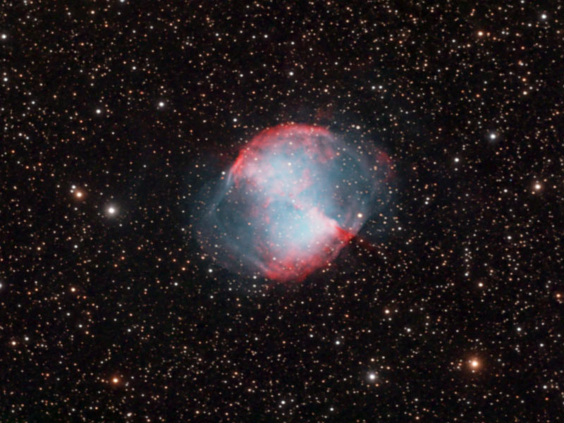

As far as the red filter, I was able to get an almost 3D effect with red on this target.

interesting, i prefer the deep reds to the higher contrast orange version that most seem to like.
you're talking visually, right?

i was just noting that all of the fine detail in m27 is in the red data. i often look at m27 with an oiii filter, but it never occurred to me to use a red filter visually. so i was wondering if anyone had observed that a red filter enhances the detail in m27 visually.
