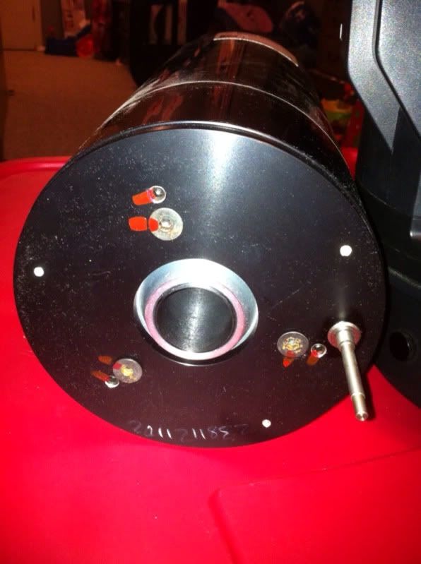

After going thru my memory and photos
Here's the back of the ota behind the plastic
Pull off the focus knob unscrew the tube pull
If you choose to remove the mirror and mirror holder remove the clip on the small tube
Slide mirror/holder and focus shaft comes with it
Here's some pics
Notice the screws with red paint,I wouldn't touch those as they are for aligning the mirrors
And notice the clip on the tube that needs to be removed if you choose to remove the mirror
Now if your not sure about removing the mirror it can be grease in place but carefully not to get excess grease on the mirror
Bring the mirror all the way back like on my pick
Grease the front half of the tube.
Bring the mirror all the way to the front against the clip and grease the back half
Just a thin coat,nothing that drips or could fall off
What the grease does is lubricates of corse but grease will fill the gap between the tubes and will make it harder for image shift to occur
As I put my grease on I rotated my mirror around the tube as I pushed it down the slide to help evenly distribute the coat of grease.
I wiped off the lil extra that built up on the back side of the mirror holder
Honestly it's all easy to do
Just take your time and don't drop anything or touch the reflective mirror service

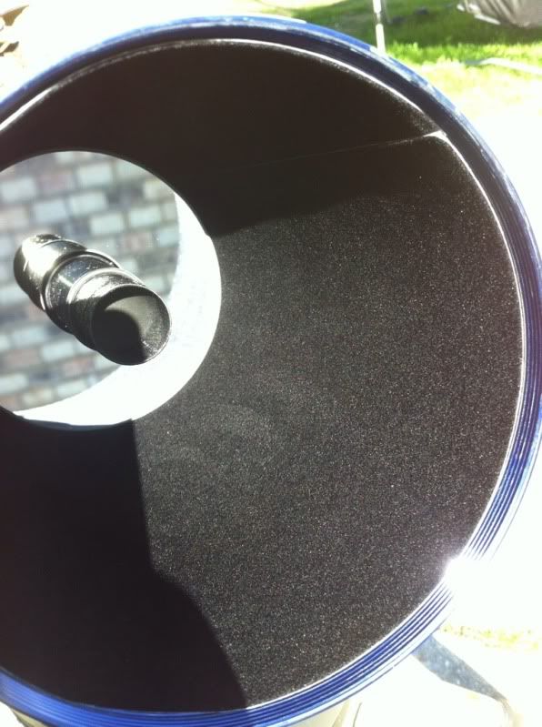

I forgot to ask from your last reply about flocking. In this picture it looks like you have lined the inner tube with some kind of felt or something? What do you suggest I use and how do you go about flocking it?
redlinedb16a
Reged: 10/17/10
Re: 125 ETX Focusing Problem new [Re: REC]
      #5826652 - 04/27/13 04:22 PM
I got my flocking from scopestuff.com
Extremely fast shipping
However the flocking is not easy to do perfect
If you do mess up the glue is so strong it will rip the flocking off if you pull it apart then the glue has to be scrapped out
It's not to hard but a pain if you mess up
http://www.scopestuff.com/ss_flok.htm
Google telescope flocking,I think there's other stuff too
