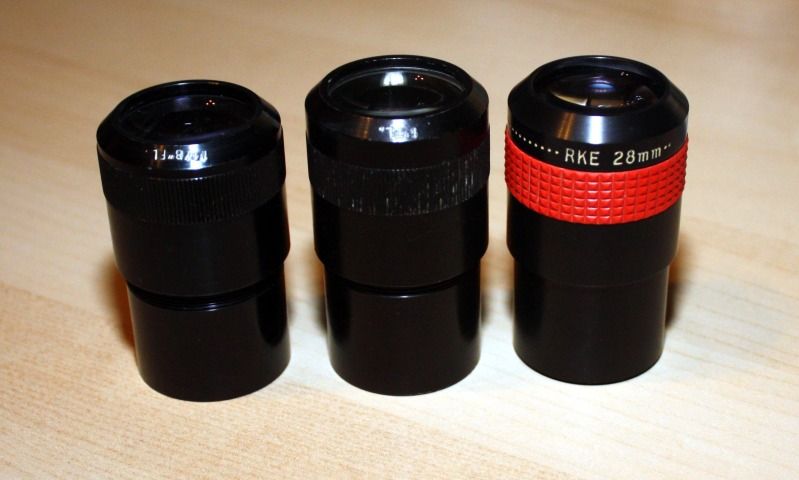

I think it's an effect produced by a large eye lens with a thin barrel surrounding it and a long eye relief. None of them has/had a rubber eyecup, either.

To Don's description of why the 28 RKE produces its effect,
"I think it's an effect produced by a large eye lens with a thin barrel surrounding it and a long eye relief",
I would add that the angle of the volcano top taper is such that it disappears from view when your eye is in the position required by the eye relief.

I have an illustration for Don's comment:
Left to Right: University Optics König II, Meade 4000 pre-1994 5 Element "Super Plössl", Edmund RKE

I will have to disagree, I feel the Pre-RKE 1" & 1 1/8" do share the same floating effect as the current RKE, the housings are very similar.
I agree with you...I have several 1-1/8" and 28 RKEs and they both behave exactly the same with the floating...they also have the same eye reliefs.
OK I'm going to have to revisit that eyepiece, try it again, it has a chip in the lens so it got mothballed,
I just don't remember that effect with it, BUT it has been
25 years,and a lot of scopes ago..
Seemed to me it was a 4 element not 3, and was optically different somehow...
Yes, the one labeled 1-1/8" is a Plossl, not a Kellner. I had the one labeled 1" also, and it was a Kellner.

Don, my 1" Edmunds is a non-symetrical Plössl similar to the 1 1/8", I just took it apart...

The 1" Edmund I had didn't look like the 1-1/8" and had a knurled upper edge and a very convex eye lens facing the eye.
I took it apart and it was a 3-element design with a doublet eye lens and a larger diameter singlet field lens.
It was also uncoated.

I'm sure mine are uncoated. I have seen many Edmund eyepieces, mostly Kellners like your previous, with imperial focal length measurements. At the time they were produced, from old military lenses, the labeling of the eyepieces were a little bit more liberal and less specific.
