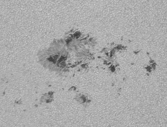

Hi All,
Lately I have been playing around a bit with speckle interferometry techniques. I'm certainly no expert in speckle interferometry - it is tricky subject - but I'll try to explain it to the best of my knowledge.
----- an edited copy/paste from a post I made elsewhere ----
Speckle interferometry is a technique that automatically creates near diffraction-limited results using a sequence of images made through a telescope. It can be applied on images that were taken in so called 'speckle bursts', where each image provides an independent representation of the seeing state at that time. This means the images must have been made with short enough exposure times to freeze the blurring, or better speckling, effects caused by the seeing ( http://en.wikipedia.org/wiki/Speckle_imaging. We are talking about speckle interferometry, not shift and add. Shift and add techniques are more like lucky imaging, but there are many different ways to determine the 'shift').
Subsequent images are best to have a small 'time gap' in between them to ensure the seeing is making the images look different from each other, usually this is in the order of 10ms (more is no problem, less might give non-optimal results). Of course you must make sure that the object itself isn't changing so much, otherwise there is no static image to reconstruct in the first place. The image also has to have a pretty high signal to noise ratio to begin with, and an extra limitation is that you have to use a relatively narrow band-pass filter (+- 10% of the wavelength or less). Typical exposure times that are needed are at least 10ms, the gain levels should be very low.
As you can imagine, not many imaging targets are suitable for speckle interferometry, but one obvious one comes to mind. The Sun.
-- another copy/paste---
With speckle imaging you estimates the actual distortions on the images (that is why it NEEDS high quality images), and you use those estimates to reverse the effect and end up with a near diffraction limited result. Automatically. No sharpening is involed. About 50-200 frames is basically enough, addding more doesn't add much more. The technique is not perfect: poor seeing will not give diffraction limited results.
In contrast, Lucky imaging just works with the best parts of the recordings, and combines those in a smart way. You will end up with a very soft image that NEEDS further processing to reduce remaining seeing and aligning/stacking blurring. If you do this correctly, then under favourable conditions you can also get near-diffracton limited results. The more frames you have the better your results. The technique is not perfect: poor seeing will not give diffraction limited results.
What I'm figuring out now is what the limits of both techniques are (well, I have a fairly good understanding of AutoStakkert!2, but I'm new with speckle imaging). The end goal is to come up with a more or less automated processing system (Linux software). Then it would make a lot of sense to get reliable 'finished' results without the hassle of lucky-imaging that requires a lot of effort with image sharpening. But this goals is still far away.
For now just a small demonstration of what the technique can do when I feed it a recording of 16 seconds that I split up in speckle-bursts of 50 frames each. So each frame in the animation is an independent reconstruction of only 0.5 seconds worth of data.
http://www.astrokraai.nl/dump/speckle_demo.gif
There is no sharpening applied to the images, this is 100% what comes out of the technique. I did not even change the brightness or gamma, or perform denoising. To the best of my knowledge of the speckle interferometry code, these images are what lie underneath the seeing-distorted images you can see attached to this post.
Notice there is still a lot of wobbling going on. This is because there are slower bigger seeing waves distorting the images, and a 0.5 second recordings is just to short for this. I have a couple of ideas on how to fix this, but that will take some time.
I will hopefuly be allowed to release binaries of the speckle interferometry code (KISIP), so others can play around with it. And I also plan to provide a small manual (or bunch of notes) on how to use it, but don't expect there to be a full working end-result anytime soon (and definately don't expect it to be easy to use ). This will take time, and I'm always short on that.
NOTE: the image below is a single frame - during what I call good seeing (95% of the time the seeing is worse where I image) - from the recording. This is NOT the reconstructed image. Those are seen in the animation above.

Re: Speckle Reconstruction new [Re: MvZ]
      #5680250 - 02/14/13 09:32 PM
.....certainly plenty of food for thought Emil, totally different in all aspects but reminding me of the conversations I've had with Jason re tone-mapping of images to enhance detail/resolution of planetary images: have only "skimmed" you post and the links and see that the low gain needs to be coupled to exposures around 10mS for the visible spectrum but up to 100mS for infra-red wavelengths.
From what I'm reading "Lucky imaging" is actually a form of "speckle imaging" and somewhat different to what we normally apply through AS!2 etc processing....?
Thus I am wondering whether we might simply be able to "extract" single images from a sequence at the start of AS!2's quality grading to create this "sequence of images" to apply the speckle imaging technique to our (normally processed) stacks to enhance detail somewhat akin to luminance layering....?
The "small time gap" you speak of could possibly be provided by skipping frames in this "best of" sequence at the start of the AutoStakkert graded stack..?
And of course, if all this isn't simply hair-brained on my part one would need to be able to extract aforementioned frames and apply whatever processing is required - but this is where my impression of "lucky imaging" seems to suggest this is merely a form of what is done already in standard processing.....as opposed to other forms of speckle image processing....?
Again - if I haven't lost the plot - isn't this what creating a specific number of the best frames in AS!2 would do anyway - but not "staggering" the frames in any way and forgetting about any mild sharpening AS!2 does with these small stacks that folks can use to determine capture qualities???
Would appreciate your response to this.....might using the red channel's (or iR!) staggered "best sequence" as a luminance overlay have some role herein.....or running a seperate avi etc of the red channel at a lower gain/framerate to be used in conjunction as a luminance....?
Please forgive any prosaic inverting of your information and the thrust of it - but I'm just a "nuts & bolts" man at heart!

      #5680685 - 02/15/13 05:13 AM
Emil,
without doubt absolutely outstanding stuff!
How many patches did you use for obtaining the speckle transfer function ?
How long does it take to reconstruct a frame out of that 50 bursts ?
Torsten

Re: Speckle Reconstruction new [Re: Kokatha man]
      #5680687 - 02/15/13 05:18 AM
Sorry Darryl, I have only skimmed your reply (I couldn't help myself..)
Yes, lucky imaging is a form of speckle imaging. It is of the form shift and add: wait for good exposures, and align and stack those. Amateur astronomers always perform image sharpening on high resolution images, because that clearly helps a lot, but I don't see that mentioned on wikipedia.
I should have called speckle reconstruction speckle interferometry, because that is really what it is called. Perhaps this clear things up a bit.
Eh.. you lost me here. I'll try to guess what you mean. AFAIK the order of the frames is important for speckle interferometry, so just selecting the best frames is not a good idea. You could select the best 'period' from your avi though, to get optimal results. That is perfectly fine.
So first: forget the "best of" sequence, we extract a good section from the entire video (or use it all). But yes, skipping could just be performed in AS!2. Perhaps no skipping is needed: if your camera operates at 50 frames per second, and you use shutter times of 1/100s, there are already 1/100s gaps in between the recordings. I myself have worked with 1/200s recording taken 1/100s apart, and that seems to work.
Apart from calibration (meaning flats + darks, or if the camera is clean enough, you can even get away with both of these. In the example I didn't use calibration at all), NO processing is required. It is just a sequence of images that go into the program, and a single diffraction limited result comes out. That is as sharp as it can be. So it would be the finished luminance layer. Of course you could play around with the recording, but in principle there is no more retrieving hidden details by wavelets/convolution/whatever, whilst this an absolutely CRITICAL step for AutoStakkert!2 stacks.
> ... staggering ...
What is that? But no, AutoStakkert!2 is a sophisticated tool that performs lucky imaging, not speckle interferometry.
>Please forgive..
Done!
So I'm basically testing the usability and limits of both techniques.
Edited by MvZ (02/15/13 05:19 AM)

Re: Speckle Reconstruction new [Re: TorstenEdelmann]
      #5680696 - 02/15/13 05:39 AM
Hi Torsten,
I think it was about 50, but I'm not 100% sure to be honest, it is not a parameter I can directly set and I haven't really paid that much attention. I know I made the patches larger and smaller, but this seemed to give the best results.
Processing one of these 50 frame bursts took about 45 seconds (which is not that bad actually), but it depends a lot on the parameters you use.

Re: Speckle Reconstruction new [Re: LauraMS]
      #5682141 - 02/15/13 06:41 PM
Tim, no. I don't think so. It would take me ages to port the code. And it isn't my code to begin with, so I'm probably not even allowed to use it like that. To be honest, I haven't looked past the main function, while I was debugging why it wasn't working for me. I will hopefuly release some binaries along with instructions on how to use it in the form of a wiki page, but that will take a little bit of time.
Glenn, my finding so far has also been that the lucky imaging tools are actually really good. But this is definately an interesting tool that approaches things entirely different. It is a lot of fun to get good results like these without too much trouble. We are used to post-processing, if we see an image that is slightly blurry (a stack) without thinking we push it to the limits (and sometimes beyond) to extract as many details as possible. Aesthetics is also important there, some prefer softer more natural looking images, others prefer enormous contrasts to make it easier to see details. In the end there often isn't really THAT much difference between the details in the image.
This techniques just gives you near-diffraction limited results. According to a recording in this wavelength of light, and that aperture diameter, the finest details are reconstructed. It doesn't work perfectly, the best results are obtained if you use it in combination with AO systems, but even without AO it appears to work pretty good at least when the seeing is reasonable.
Laura, yes, I'm using the KISIP software (I contacted Dr. Friedrich Wöger). The wavelength was about 585nm. The data was recorded at about 100/120 fps using a basler ace aca640-100gm camera 1.5 years ago. Shutter times were somewhere around 1/200-1/250s. I indeed used the ND 3.8 solar filter (a piece of foil). These recordings were actually taken in good seeing conditions, I still have to see what it can do in poor conditions, but the results will probably be (much) worse. Otherwise there would be no need for AO or good telescope locations
Edited by MvZ (02/15/13 06:43 PM)

      #5682190 - 02/15/13 07:18 PM
Thanks for the data, I think I need to try as well... (so many interesting things to try with my new camera).
I've never completely understood the role of speckle interferometry in AO. I guess it becomes clearer with larger apertures, where AO can restore most of the wavefront error introduced by the blurry atmosphere, and SI restores the remaining errors in the AO-reconstructed image.
Emil, may I ask if you have an idea of how small the smallest structures in your reconstructed image are, and how this number compares with the theoretical resolution of your scope at the wavelength used? It would be interesting to compare these values.
Ignoring the numbers, these are really impressive images, congratulations! And what I also like about the methodology is the fact that there appears to be less subjective influence of the observers taste as it is obviously present in post processing of data acquired by lucky imaging. Well, at least from a scientific point of view this may be important. It is of course of less importance if one does the imaging just for fun... (as probably everyone here is doing).
Edited by LauraMS (02/15/13 07:30 PM)
MvZ
Reged: 04/03/07
Loc: The Netherlands
      #5682252 - 02/15/13 07:56 PM
You should be able to calculate it using:
image scale of about 0.32" per pixel
imaged in 585nm light
with 254mm of aperture
But it is difficult to measure, especially since this recording was a bit undersampled to begin with. If I had to guess, than occasionally in this animation areas are in fact diffraction limited. This is mainly a guess from my experience with these kind of recordings. It's not easy, but planetary astrophotographers can get extremely close to diffraction limited results. This is perhaps best seen if you compare an infrared light result to a green light result under good seeing conditions: you can then see that the smallest features in infrared light are in fact much fatter than those in green light, even though the infrared light (>700nm) is (much) less affected by the seeing. Actual measurements are a bit tricky I guess, I think you would need a lot of measurements to get a reliable results, and in this case you would probably be measuring a length of 1 or perhaps 2 pixels. From 1 to 2 is a huge difference.
>And what I also like about the methodology is the fact that there appears to be less subjective influence of the observers taste..
Exactly. It is pretty cool that you can get reliable results of what the image should look like, without the user having to spent a lot of time tweaking and perfecting what it thinks an image stack should look like. But in this sense it would perhaps also be possible to apply a similar 'standardized' processing (blind deconvolution) on stacked images, as long as we know the essential parameters of the system. It just has never been done before (although some attempts have occasionally been made. But I guess it is also not easy).
