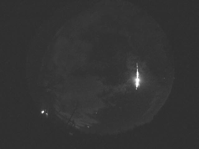

I have already caught a couple big ones and since 12/19/11 when I went live I have recorded 22! It is pretty cool.
Big fireball.
Big fireball.

I caught another big one last night. Man you never know what is going on overhead when your in the bed!!
Man that is an AWESOME one!!!

Here is my mounting on my second story chimney.
Here is my first fireball over LA shot:
Here is the video link:
LA Fireball
I love this stuff!

The PC to control everything is in my attic. The other camera you see is my Orion All-Sky Cam.

Nice catch Dave, and cool mount.
I guess you don't have too many fires??

Not on that side of the house. It's gas anyways. I'm going to put up a piece of sheet metal to deflect it to the other side.

Wow! That's a nice clean looking setup. Great video capture as well.

I caught a really big one last night!!!
Fireball in NC 2-13-12
John Wunderlin
Reged: 10/01/04
Loc: Mineral Point, Wi
Re: Source for cheap all-sky cam? new [Re: MrKrink]
      #5070802 - 02/13/12 04:35 PM
SWEET! Great catch!

      #5107255 - 03/05/12 08:24 PM Attachment (10 downloads)
Captured an awesome meteor tonight here in PA that moved across half the sky.
http://skysentinel.nmsu.edu/allsky/viewer/237401
Edited by njrusty (03/06/12 02:27 PM)

      #5121482 - 03/14/12 08:56 AM Attachment (14 downloads)
Caught my first one!
Posted to my facebook
Let me know if it didn't work

      #5121536 - 03/14/12 09:45 AM
Nice one Mike!!!

There was a fireball over Sharon Georgia last night, at approximately 23:09 EDT. An all sky camera at Deerlick Astronomy Village captured the event, and I'm attaching a still shot. I don't have access to their video files, and no one from DAV has posted a video as of yet.
We were having a thunderstorm during this time, so my camera was only capturing lightning and clouds. I think the same was true for Stuart's camera in North Carolina.
http://wkateam.com/astronomy/davmeteormarch25th2012.PNG

That's a nice one! I caught a couple small ones a few days ago and a flare last night. Still need to make some minor tweaks to the mask to get rid of some falsies.
