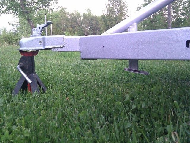

Of course the trailer could not rest on its springs so we needed a way to lift it off the ground. The four drop leg trailer jacks also provide a way of polar aligning the trailer and were slightly modified to contain set screws (3/8 bolts) to lock the feet into position and remove any residual wobble from the legs. There is also a small foot welded onto the front of the trailer to provide 5 points of contact in total. The main angle of the wedge on the trailer is about 30 degrees from the horizontal. When the nose of the trailer is dropped the angle becomes 51 degrees from the ground which makes the optimal latitude 39 degrees (90 - 51). So Denver would require very little lift This makes for a fairly wide range of latitude given that the drop legs provide close to another foot and a half of rise either way. (I am currently at about 47 degrees and can get there no problem.)
