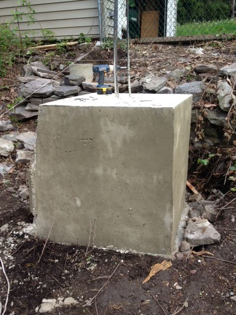

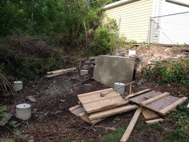

Footbag
Reged: 04/13/09
Loc: Scranton, PA
Re: Loose Rooster Observatory new [Re: dmdouglass]
      #5860371 - 05/14/13 04:52 PM
Ask and you shall receive...

The concrete came at 7:30am. And everything was going perfect. Too perfect!
Then just as we got the form filled, the bottom burst.
Fortunately the rope(Thanks Alex)and the other supports held and we were able to recover nicely. But not before a tense moment.
So the job is done, I'm happy, and it cost 1/3 of what I was quoted by the guy who stood me up three times.

Well, the form won't be nearly as ugly as it could've been. I cleaned up a lot of the spillage and if anyone looks under the obseratory at the pier base, I'll have a nice story to tell them.

The forms are off and the blowout doesn't look so bad...
Overall site picture...

Wow, thats a huge footing and pier. what do you hope to put on there in the future, a 24" Sct Or larger?

      #5888737 - 05/28/13 11:25 AM
Adam,
Nice looking pier. It ought to be rugged enough
to hold whatever you want to put on it. What I did,
because I'm lazy, after I poured my footing, is started
building my pier with cement blocks (cause I already had them). When I was approaching ground level I looked at the
blocks and was afraid there was too many places for frost to
grab hold and start lifting or shifting the pier. I had and
old 55 gal drum with one end open. I looked at it and measured the diagonal of the pier which was 16 x 16 inches.
Voila! It was just under 24" so I cut out the other end of the barrel and slipped it down over the blocks and filled the surrounding area with cement.It saved me from having to
build a form and mixing as much cement. Ihe pier has been
there for 17 years and has never been affected by frost.
Norm
I don't know what may go on there in the future, probably a combination of OTA's. But now, I don't need to worry about it.:) Only 6" below it was bedrock, so I figured over pour it above ground. The price is pretty much the same for a cu yard or two cu yards after delivery as well.

Love the logo !!!
And the cement job seems to have been saved quite well.
