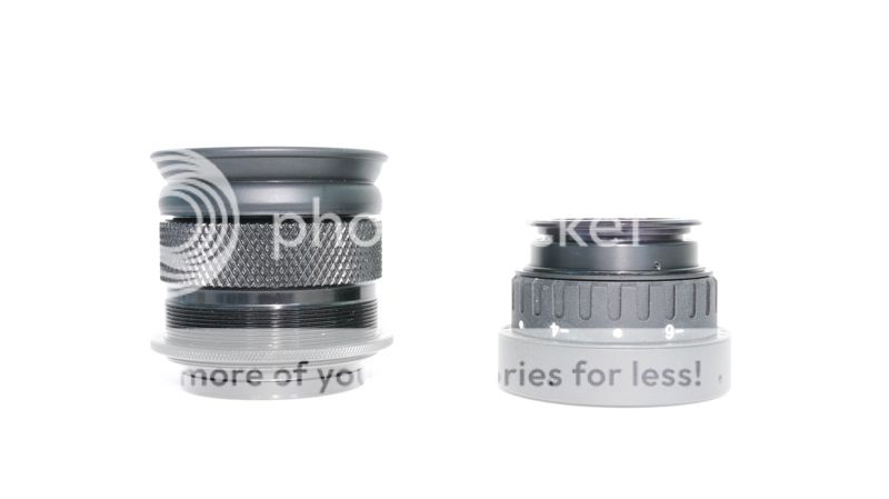

Re: DIY Intensified IIT setup for around $200 project. new [Re: De Lorme]
      #6328211 - 01/22/14 12:09 PM
Hi De Lorme
I dismantled a cheap 15mm Celestron eyepiece which came with my telescope and experimented with putting the lenses in different positions using washers until I found the perfect position for it to focus on the rear screen of the cascade tube.
I made an eyepiece holder by cutting the end off an eyepiece cap and stuck that in place - this allows me to use the single adapted eyepiece on both of my cascade tubes, depending on whether I want to use the one attached to my telescope, or the hand-held unit.
Probably a bit crude compared to other peoples solutions, but it works well for my setup

De Lorme
Reged: 12/30/08
Re: DIY Intensified IIT setup for around $200 project. new [Re: Furmo]
      #6331852 - 01/24/14 02:31 AM
Furmo which Celestron 15mm{Plossi, Ortho} are you using? Would you take a picture so I could see how you attached the eyepiece? Exactly what do you mean by dismantled and
how did you apply the washers. OH Please give me a picture!

Furmo
Reged: 01/17/13
Loc: York, UK
      #6340251 - 01/28/14 05:58 AM Attachment (26 downloads)
Hi De Lorme
Please see the attached photos!
The eyepiece holder is simply an eyepiece cap with the end cut off and then superglued into place - it actually fits PERFECTLY into the rubber ring around the projection screen.
The eyepiece I took apart came with a Celestron accessory kit I got free with my Nexstar scope. It had 2 glass elements and I just experimented with swapping them around in various positions using plastic rings and washers before I found the perfect position. I tested this by placing the EP on a mobile phone screen to see if it reached focus at (effectively) zero distance.
I think I actually ended up using the bottom of the 2 elements placed on top of a plastic ring which was originally on top of it (if that makes sense) so after all the trial and error, I didn'y actually use any additional parts!

      #6340252 - 01/28/14 06:01 AM Attachment (21 downloads)
I just realised I can only post one picture with each message - this is what the EP looked like before I dismantled it:

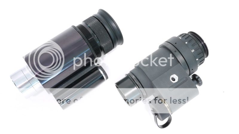

      #6348978 - 02/01/14 11:51 AM Attachment (23 downloads)
Here goes, simple, keepeaning to put it in a proper tube. Probably need to blacken the lens end to stop stray light.
Peter

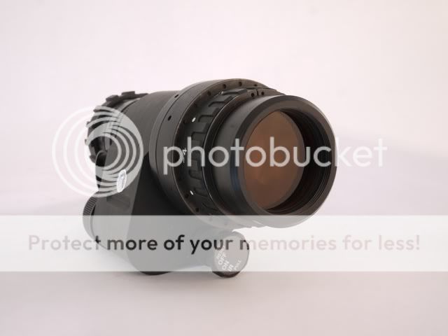

      #6348979 - 02/01/14 11:52 AM Attachment (19 downloads)
And

      #6350526 - 02/02/14 02:41 AM
Pretty close, it came with a clear spacer to hold it at focus which was removed. The printed parts have a helical focus that works well but might need a tint bit of sanding to get working first time. The front lens mount is a cmount spacer FORCED into place so it'll never go anywhere.

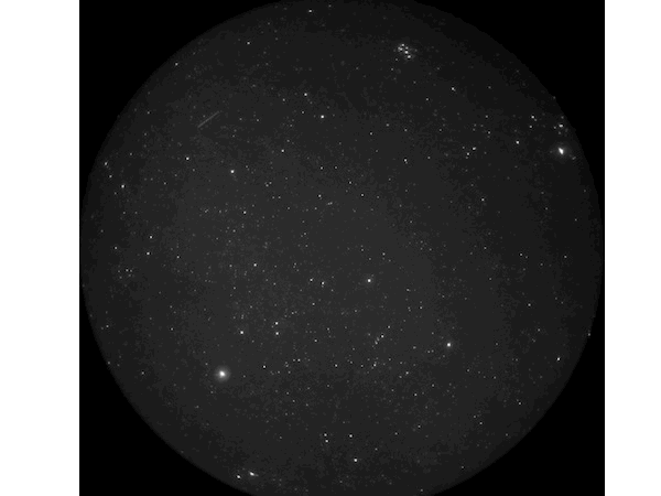

      #6359469 - 02/06/14 11:00 AM Attachment (32 downloads)
Hi
I would apologise for the late reply but I'm sure you are probably bored of hearing it!
With regards to the eyepiece - please see the attached photo showing how the eyepiece slots into the holder on the screen end of the cascade tube.
With regards to the extension tube that attaches the cascade tube to the telescope OTA, it actually slotted perfectly around the inner metal ring on the input end (where you attach one of the power wires) which allowed me to superglue it and then secure with duct tape. I have attached a photo of my other tube which I made into a handheld unit so you can see what the inner ring looks like.
Finally, I note you mentioned gain control earlier - both my 8079HP tubes have built in automatic gain so I don't know if any external circuit would just get over-ridden by the internal control. It's a pain as you can't manually bump up the gain, but it does mean that when you accidentally point it at a streetlamp, or turn it on during the day, the tube doesn't get fried!
I hope that is helpful.

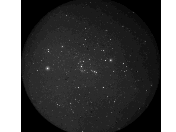

      #6359472 - 02/06/14 11:02 AM Attachment (29 downloads)
And here is the input end of the tube showing the inner metal ring.

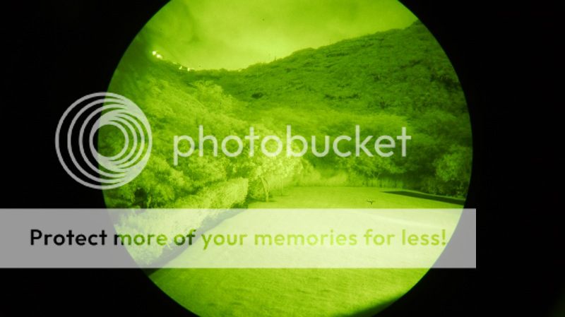

      #6363364 - 02/08/14 04:39 AM Attachment (23 downloads)
Furmo, Peter, and cuivienor, In my quest to find a better eyepiece I ran into "DIY Cascade Tube Thread"{page 9}under AR15.com. The first picture show an image with a loupe ocular, and the second with PVS-2.
Looking better all the time. De Lorme

      #6363365 - 02/08/14 04:44 AM Attachment (22 downloads)
The picture through the PVS-2. What a difference! This is just great. De Lorme

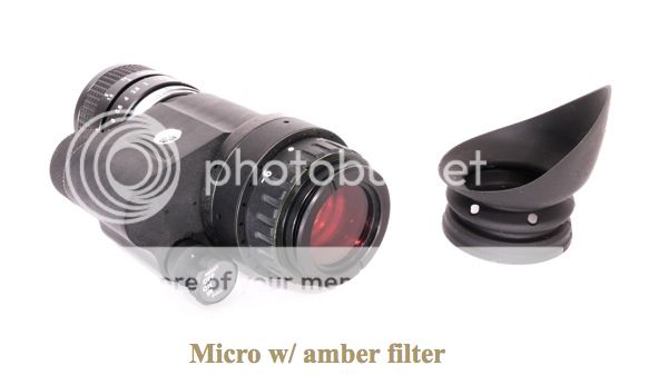

      #6364717 - 02/08/14 07:25 PM Attachment (21 downloads)
Hi Every body, The next 2 pictures shows the 8079HP just before attachment and then after. De Lorme
De Lorme

      #6364722 - 02/08/14 07:28 PM Attachment (19 downloads)
And now the one attached.

Here is a link for the PVS-2 (Varo)eyepiece,

And here is the eyepiece with rubber shield,
http://www.ebay.com/itm/Lens-VARO-Night-Vision-Monocular-Eyepiece-Device-Rubb...

      #6386050 - 02/20/14 04:52 AM Attachment (14 downloads)
Hi Peter, and Vondragonnoggin, I put the foil back on which is now sandwich between 2 Gorilla tapes. The whining came back but not nearly as bad as before. Why does it whine with foil and not without it? Here are a couple of picture.
The second one shows the 2" to 1.25 filter adaptor{from scope stuff}in front of the intensifier. When taking off the cap the filter fits perfectly on the ID{where the threads would ordinarily go} and the OD also. I couldn't believe it when I first inserted it. The focus reducer glass sits between 5/8" and 3/4" from the screen. Is this close enough to achieve focus? I believe so but would rather find out now rather than testing to find out. This is really exciting! I should have rubber band the{Radio Shack}battery box to the intensifier but I forgot. It's just a square box 2.625 x 2.75. Soon I launch. LOL De Lorme
De Lorme

The amber filter your referring to was an accessory for the M17 Elbow Telescope (WWII Era). Those filters can be had still, don't know how easily but there is an alternative that's nearly identical and may in fact be identical. Here is where I suggest you look for an Amber Filter, go for the 30mm with a part # of 03492P2. If you do order an amber filter from them make sure you order several, they do tend to be chipped.
Photo of the amber filter from the m17 fitted to the ocular of a Micro Monocular
The amber filter is placed on the output side of the image intensifier either between the ocular and output screen or between the viewers eye and ocular lens. Using one decreases the perceived output brightness of the image intensifier and shifts it more towards the red end of the spectrum. That of course reduces the chance of eyestrain as well as minimizing effects on dark adapted vision and the time needed for the eye to re-adapt. The color shift does seem to help contrast as well so that your better able to see regions and structures that may have lower contrast.
Another effect of using an amber filter is the filters effect on scintillation noise. This noise appears to be white-bright yellow against the background color of the overall scene. The filter has a massive effect on that noise components and gives the impression of a calmer/smoother image. I will stress that I have not tried it with a 8079HP intensifiers but do caution placing one or anything on the output screen of the 8079HP as you might end up with voltage bleed.

And on the Collins I3, don't bother unless you can pick one up super cheap, their are vastly better options available. The housing of the I3 is pretty nice, has that lab equipment appearance and feel which I really do fine appealing but the the ocular just ruined it. Not sure why Mr. Collins chose to have Televue supply modified telescope eyepiece's instead of just using the ocular spec'd, selected and approved by NVESD for use with the 10160 type image intensifier. The modified 25mm Televue ocular and 15mm ocular used on the I3 are great optics for a telescope but not for the unique output of the 10160 type image intensifier. The I3 ocular negatively effected image scale, induced edge distortion by not matching the output curve of the image intensifier and reduced the perceived output bright of the image intensifier i.e. I can't know why the ocular used was chosen but I do know it was not the right one to use.
Collins and Micro Monocular
Collins Ocular next to Ocular from Micro Monocular
Here are two photos that detail the difference in image scale between the Collins and Micro Monocular
Picture below is through Collins I3
Picture below is through Micro Monocular

      #6418679 - 03/21/14 07:06 AM Attachment (5 downloads)
hey this thing works better than I thought for a g 1
was able to see California, rosette nebula with
7nm ha 2 inch filter
here is what my test rig look like
I will put it with my 6 inch f1.5
but that's to heavy to test with

      #6425250 - 03/23/14 07:32 PM Attachment (9 downloads)
Optical Filter, Astronomy Na & Hg skylight reject, 62mm
David, Take a look at the above filter. I think it would be better than the Moon & Skyglow ; what do you think? This filter comes in both the 2" and 1.25.
Would the Baader 495 LongPass interfere with the Na & Hg rejection filter? "Seek and You Shall Find" Thanks De Lorme

      #6433267 - 03/27/14 09:08 PM Attachment (6 downloads)
finally figured a way to take clear shots
afocal c-mount camera attached to eyepiece
inside test shot
of course
clouds rolling in to deny me my fruits of this labor!

I finally got some decent shots thru this device
I wish to thank c7jhawk and De Lorme for heads up on this
one - I was raised that gen 1 was useless
not in this case!
http://www.cloudynights.com/ubbthreads/showflat.php/Cat/0/Number/6440546/page...
Those are great shots, Barnards Loop is very impressive. How does this intensifier compare with gen 3 you have used?
highfnum
Reged: 09/06/06
Loc: NE USA
Re: DIY Intensified IIT setup for around $200 project. new [Re: Dxvid55]
      #6440980 - 04/01/14 07:58 AM
very well better than G2
G3 has less distortion(flatter field) and less weight
g3 picks up a bit more of fainter stuff
g1 has brighter image and less noise but only zone 1 is good for astronomy zone 3 real bad
I think i got a way to design an eyepiece to get rid of most distortion -- future work
when you consider its 1/10 price of a used g3 very well indeed. Very funny a good 2 inch H-a filter will cost same or more that tube itself!

Peak Optics makes some pretty good loupe's.
The 10x loupe (#1983) is really good and was at one time used by STANO Components on a number of their MX-9916 based night vision scopes.
I can't comment on their zoom loupe's but the 10x mentioned above is outstanding, for a loupe that is.
Here are a couple pictures of the ones I owned that use the Peak Loupe:
