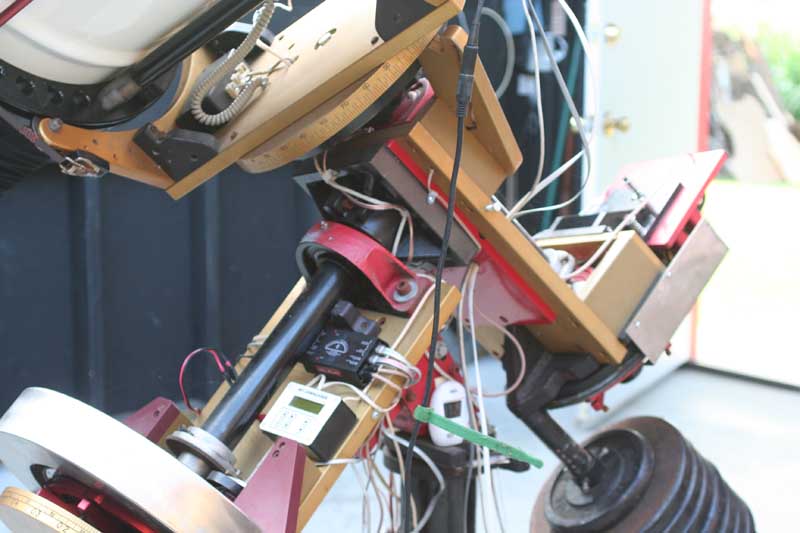

I choose taped roller bearings for both axis.
but find that if decide a D40 mm balance bar, than will trigger a lot of unexpected clumsy design for bearings and shafts....the result is:
1.Dec: ID80,ID70 bearings
2.RA: ID100,ID90 bearings
then even a 10" scope looks small on such a mount. I think it need to be optimized to fit my goal--12" reflector. but no idea to start with....
thank you for suggestions~~

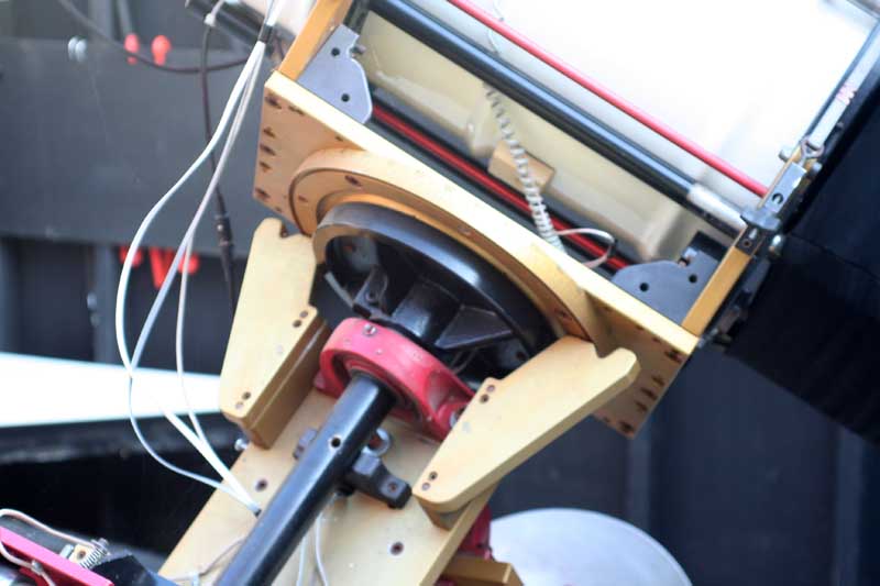

      #3332192 - 09/13/09 09:01 PM Attachment (31 downloads)
taped roller bearings for both shaft

Re: mount design puzzle~~~~ new [Re: cnchillstar]
      #3332309 - 09/13/09 10:05 PM
Vixen uses tappered bearings , I think they are thrust bearings , and they wind up with a mount capable of precision guiding with scopes larger than 12". That's a lot more compact that the one drew up.
Maybe you should change your bearings .
Edited by Ian Robinson (09/13/09 10:11 PM)

does anyone use a meade max mount? is the counter weight bar screwed in Dec shaft or only screwed in the interface block?
if I make a smaller bearing, it will be not enough diameter for a 38mm balance bar.
thanks a lot!
      #3332811 - 09/14/09 06:44 AM
Max Mount never got beyond prototype stage.
You don't need such a large diameter counterweight bar.
Your shafts are HUGE, and the mount will weigh a LOT.
You have no idea how to design a mount and would be a lot better off buying a used one. It will probably be far cheaper in the long run.

Re: mount design puzzle~~~~ new [Re: Ian Robinson]
      #3332963 - 09/14/09 09:16 AM
Large shafts, tapered bearings, indicate large capability for later on.
As an overall design, yes this will be ok - it is a heavy weight solution, but if it is planned for your observatory, then that should be fine.
As a suitable source - timken bearings for automotive use will be relatively inexpensive, and more than robust enough
I'd look to making the 'bars' tubes to reduce some weight with out compromise, but this 'should' (if the plate is properly welded, and the bolts suitable substaintial) be immensely solid.
